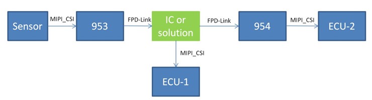

Hi Team,
The picture below is the signal chain, the green box can deserializer the 953 FPD-LINK signal to MIPI which will be send to ECU-1, and it can also transmit the 953 FPD-LINK to 954.
So is there any signal device which can meet the requirements?
If not, should 960 and 953 total solution be the best?
Thanks and Best Regards!
