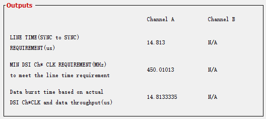

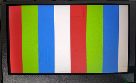

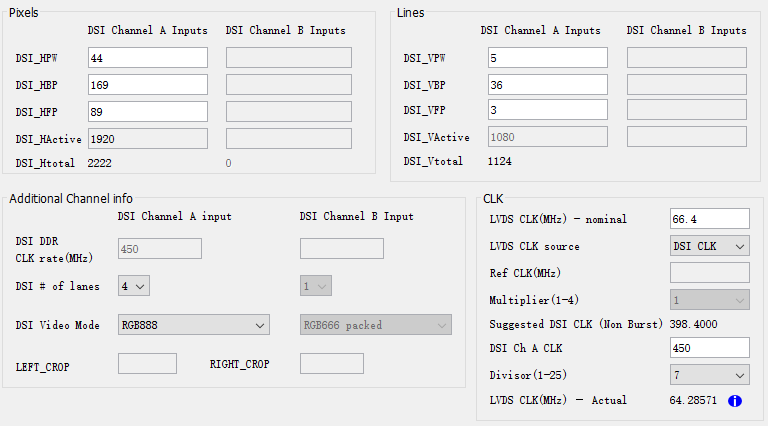

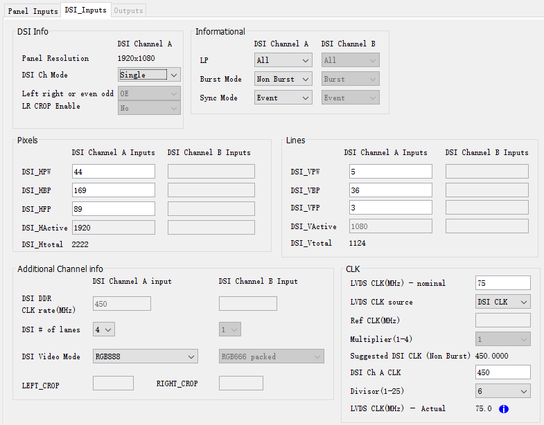

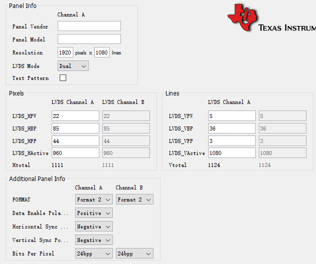

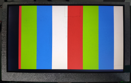

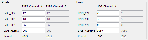

Our dsi config works fine with a dsi-interface panel, and the dsi dphy bitrate is 900Mbps.
data path is:dsi source (900Mbps) --> sn65dsi94 --> lvds panel

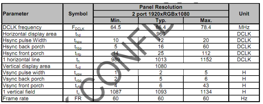

I just can't get the the 2 times in Ouputs window the same.
How can i get the dsi source correctly convert to lvds the panel needed?
Do i have to change the dsi dphy bitrate so that the lvds clk can perfectly match?
Here is my dsi status configuration, plz help.
