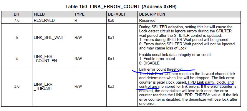

  • Hi Hamzeh,
    thanks for your feedback.
    1. What I mean is the link error count register, like 0xB9 in UB954. Is there similar register in UB914 and UB934? and what are the address?
    2. what status will UB914 AND UB934 monitor for LOCK pin output? for example, UB954 will monitor parity, clock and control.
    3. what are the specific checking will it do for FPD Link clock and control monitor? does this mean it will monitor FPDLINK signal clock jitter and something else?
    thanks!
  • Hello Terry,
    In the 934 it has the same register address as the 954.
    The 914A does not have such a register.
