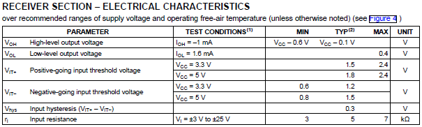

I have some questions for MAX3232EIPWRQ1
1. In datasheet below, will input be recognized as low if voltage at receive input is lower than Vit-? According to TIA/EIA-232-F , -3V~+3V input is not valid.
2. How to configure unused drive and receive pins? Thanks!
