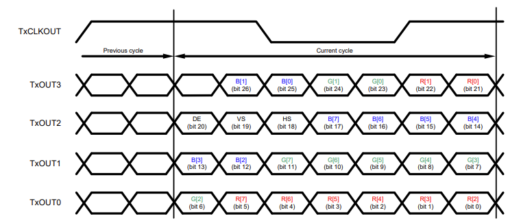

Dear Teams,
My customer is asking how to connect the data to the pin if they have a 8 bits LVCMOS data input for DS90CR285? Also, what is the order or sequence they need to connect for individual pins?
Thanks!
