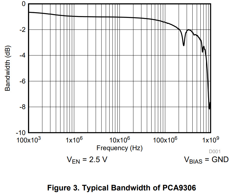

  • Yihua,
    It is likely that your FAE was also giving you correct information. Please note that the PCA9306 supports fast mode (400 kHz) as noted in the datasheet. I am assuming that this is the information you were provided by the FAE.
    In addition to fast mode, also noted in the datasheet section 9.2.2.3, "The maximum frequency of the PCA9306 device depends on the application. The device can operate at speeds of >100 MHz given the correct conditions. The maximum frequency is dependent upon the loading of the application."
    You will notice as shown in Figure 3 that the device reaches -3 dB around 250 MHz.
    The high capacitance of the bus that you mention provides a source of concern, but it is not disqualifying for the device.
    Danny
