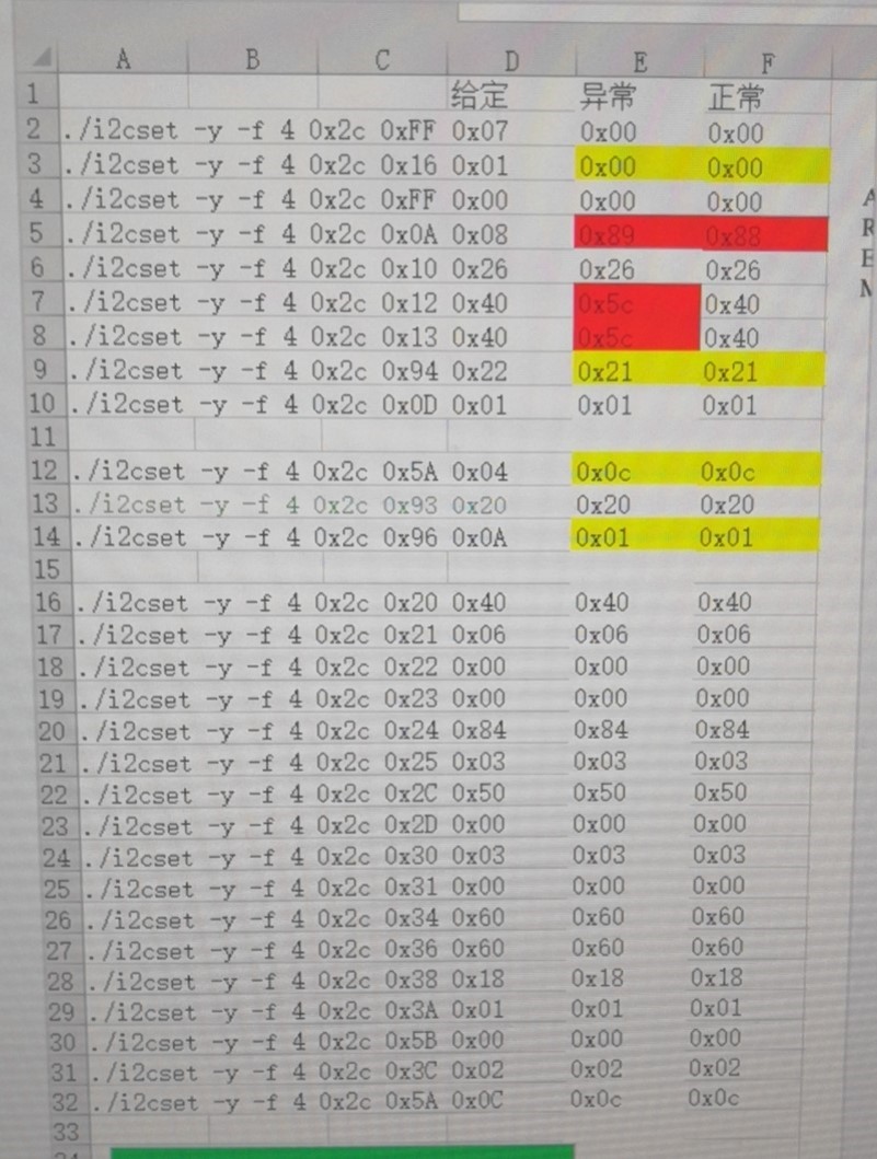

SN65DSI86: DSI86 EDID read wrong when keep on plug in and out
Part Number: SN65DSI86
Hi Team,
One of my customer said, if they continued plug in and out the screen on DSI86, the EDID value sometimes will be wrong. And everytime when it is wrong, the wrong value are same. So they are wandering if the wrong value is our default value. And ask what kind of the time sequence can make them not be able to read the wrong value.
