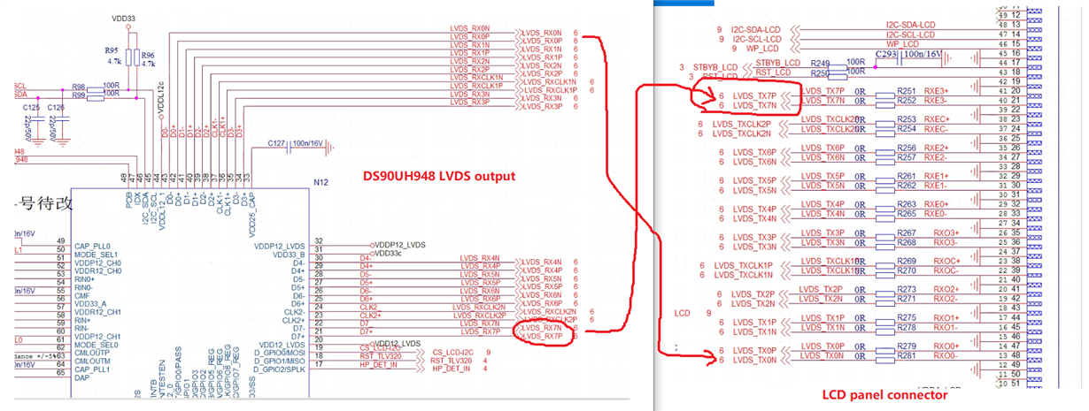

Hi team,
Our customer wants to use our DS90UH948-Q1 to match one below LCD panel which has totally swapped LVDS pairs and polarity. They want to know if our device can make the swap function to match their LCD panel interface to easy PCB layout without trace crossover.
We noticed that there is one post as below to mention the dual SWAP output mode for DS90UH948-Q1, but it looks like that it can not meet customer's requirements.
Can you help to check if we can make below swapping?
Thanks.
