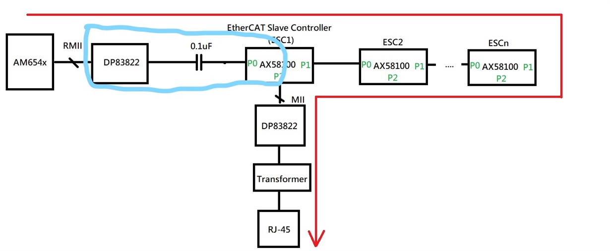

Hi Team,
My customer has a new project and the Ethernet(EtherCAT) structure is as following block diagram.
Since the P0 of AX58100 is MDI interface that is voltage mode, so
1. Can DP83822 connect to AX58100 via MDI interface directly?
2. Is it workable to establish connection between voltage mode and current mode on MDI interface. If it is possible, is there any reference circuit can be shared with customer?
Thanks a lot.
