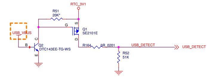

We have experienced some USB-C compatibility issues (our product was not being recognized as a USB device) when connected to some laptops (M1 MacBook and HP Elitebook 850) directly via USB-C to USB-C cable. However, there is no issue when our product is connected through a USB hub or when using a USB-C to USB-A cable. This seems to indicate there might be some potential issues with the negotiation between the TUSB320 and the laptops but we couldn't pinpoint what exactly is the problem. We would like to know if anyone has seen this issue before and we really appreciate any recommendations.
