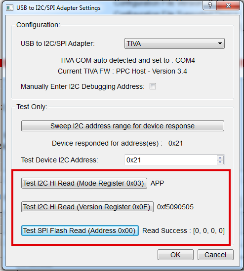

    It's good that you're able to read from the registers after power cycling since that means the base firmware is able to recover from the invalid programming.
    The fact that it says "Invalid region pointers" is definitely concerning. Here's some steps we can take to try to get the HW back into a known good state:
    1. Open the Application Customization Tool and go to Project -> New Project and load the TPS65982 device
    2. Once loaded, connect your Hardware to your PC and go to Adapter -> Configure I2C/SPI Adapter Settings
    3. In the dialog menu that pops up, change the USB to I2C/SPI Adapter to Aardvark
      1. Click on the Sweep I2C address range for device response button and verify that it finds an address
        1. If it can't find a connection, then there's an issue with the hardware connection
      2. Click on the Test I2C HI Read (Mode Register 0x03) button and verify that the device is in APP mode
      3. Click on the Test I2C HI Read (Version Register 0x0F) button and Test SPI Flash Read (Address 0x00) buttons and verify that they are successful
    4. If everything works across the board, close the USB to I2C/SPI Adapter Settings dialog and return to the main GUI window

  • Thanks for the quick reply.  I'm not in APP mode, see the attached pics.  I'm getting garbage back in that field.  Everything else looks good.
    I can't find the HI Firmware Update under the Device 1/port 1/ Commands menu, and I can't find the  "Load saved Low-region binary file from Computer"  menus anywhere in any menu.  Is this because APP mode is corrupt?
    More screens attached that show reads from registers, and the pjt file.  Basically, we want the same configuration as the eval board, but with it configured such that it uses PP_5V switch enabled to power VBUS.  We are not using PP_HV.

  • Dave,
    Thanks for the pjt and the pictures. Based on that information it looks like the fundamental issue is that the device is in a bad state. We need to get it into a known good state before we can look at anything else. A known good state will have the device report in APP mode, with the Version showing the Firmware version as 0001.12.09 and the SPI Flash Read return success. It'll look something like this:
    Go ahead and execute the following process to try to recover:
    2. Load Project
      1. Use this attached project: /cfs-file/__key/communityserver-discussions-components-files/138/TPS65982_5F00_DRP_5F00_Host_5F00_Standard_5F00_611.pjt
    3. Binary -> Flash from Current Project
      1. Leave the default regions. Since your device seemingly has corrupt regions, Reading will likely fail
    4. Power Cycle Hardware
    5. Use my previous instructions to read the Mode from the Adapter -> Configure I2C/SPI Adapter Settings menu
    You should now be in APP mode and able to work with your pjt file.

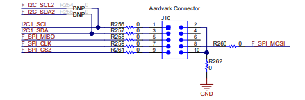

    TPS65982_Schematic.zip
  • I scoped the SPI signals, and clearly have contention of some sort when using the config tool, but not with the Aardvark flash tool.  So either my schematic is wrong (MOSI/MISO flipped?) or my assumptions on how to connect the config tool are wrong.
    I have the Aardvark hooked up to the SPI signals as in SLVUAF8C page 39.  I also have the same Aardvark connected to I2C1.
    If I use Aardvark flash tool, I power down the board and just power the EEPROM, and can read/write the flash.
    If I use the same wiring, but with 65982 powered and using the config tool, I have contention on the SPI data pins.  I assumed that the I2C channel would tell the 65982 to release the SPI bus so that the flash could be read.  Appears to be not the case.  Or I my schematic has an error, we intended to wire it as in the EVM schematic on page 29.
    What is the correct way to connect this to use the config tool?
    Thanks a lot,
    Dave.

  • Dave,
    The connections on your Aardvark to dot match the version that I am used to seeing.  Here a capture off our our TPS65988 EVM.  I had it most on hand.
    Can you make a jumper cable or use 100 mil male to female connectors to re-route your connection to match the one that is shown?
    The grounds are correct, but none of the other connections look right to me.
    I do not believe that there are 2 different Aardvark mappings, so this is most likely the cause of your issue
  • Hi Chuck,
    The Aardvark connections are mapped correctly off the board.  I can use the Aardvark flash tool to read and write the eeprom directly with the same connections, but cannot write to it using the config tool.
    So something is up with the config tool I think, or the wiring from the eeprom to the 65982.  Does that look correct to you?
    I can also scan the I2C addresses with the config tool and read back status from the 65982.
