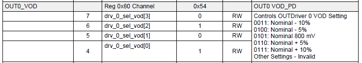

I would like to ask about OUT0_VOD setting.
Programming guide shows the following and there is only 5 settings to adjust and other setting is invalid.
-LMH0318
On the other hand, it seems LMH1218 can be set more detailed setting (more than 5 setting).
-LMH1218
Should we consider adjusting OUT0_VOD of LMH0318 is resticted than that of LMH1218?
