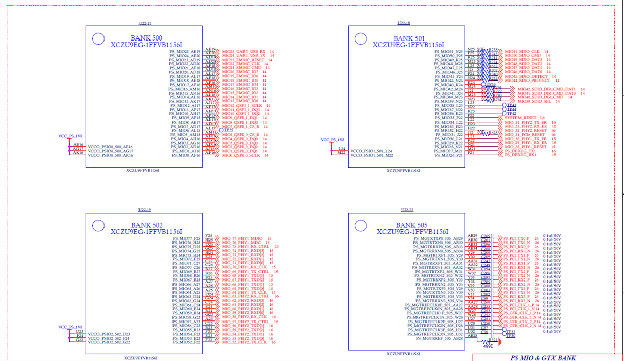

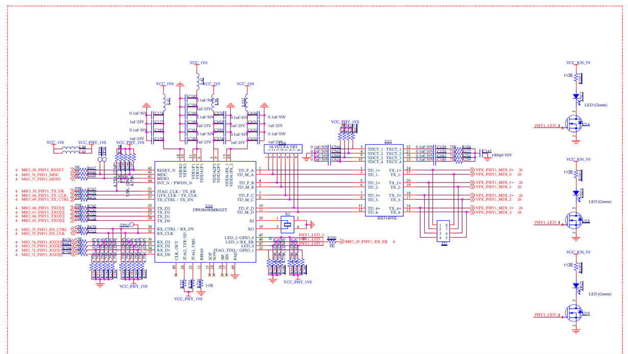

    Can you also provide a schematic?
    Thank you,
    Nikhil

    here is the schematic sir for your reference
    Hoping for Best and Quick Reply sir
    Thank you
    regards
    Balakrishna J
  • Hi Balakrishna,
    Please see my feedback below:
    • Remove pull-ups on center-taps of transformers. Refer to Figure 111 in datasheet for schematic diagram.
    • JTAG_TDO should be left floating for RGMII to Copper mode. If strap resistors are placed, it may be strapping device to different Op Mode.
