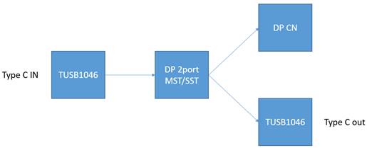

Hi team,
Do we have part that could split DP information from TUSB1046? Below image is our using scenario.
Roy

For sink side application, you should use the TUSB1064, not the TUSB1046.
For DP splitter, please take a look at the STDP4320 which is a 1.2a splitter.
David
