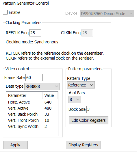

I want to use Fixed Color Patterns to test first, how can I setting the registers. I want to use YUV422B8 VC0 to try test pattern.
Hello Xue,
If you can use the graphical Analog LaunchPad interface connected to 954, then there is an easy way to configure the pattern generator: https://www.ti.com/tool/ALP
If you can not use the SW on your end, please provide the video parameters above and we can help you generate the registers
Casey
Hi Casey,
I tested pattern mode is okay.
