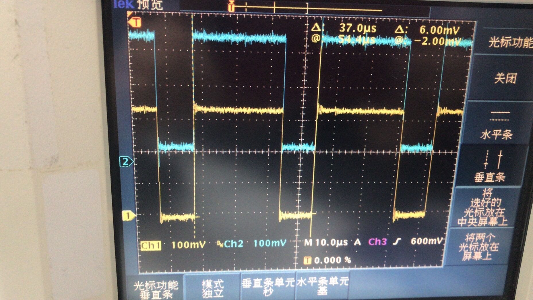

Hello

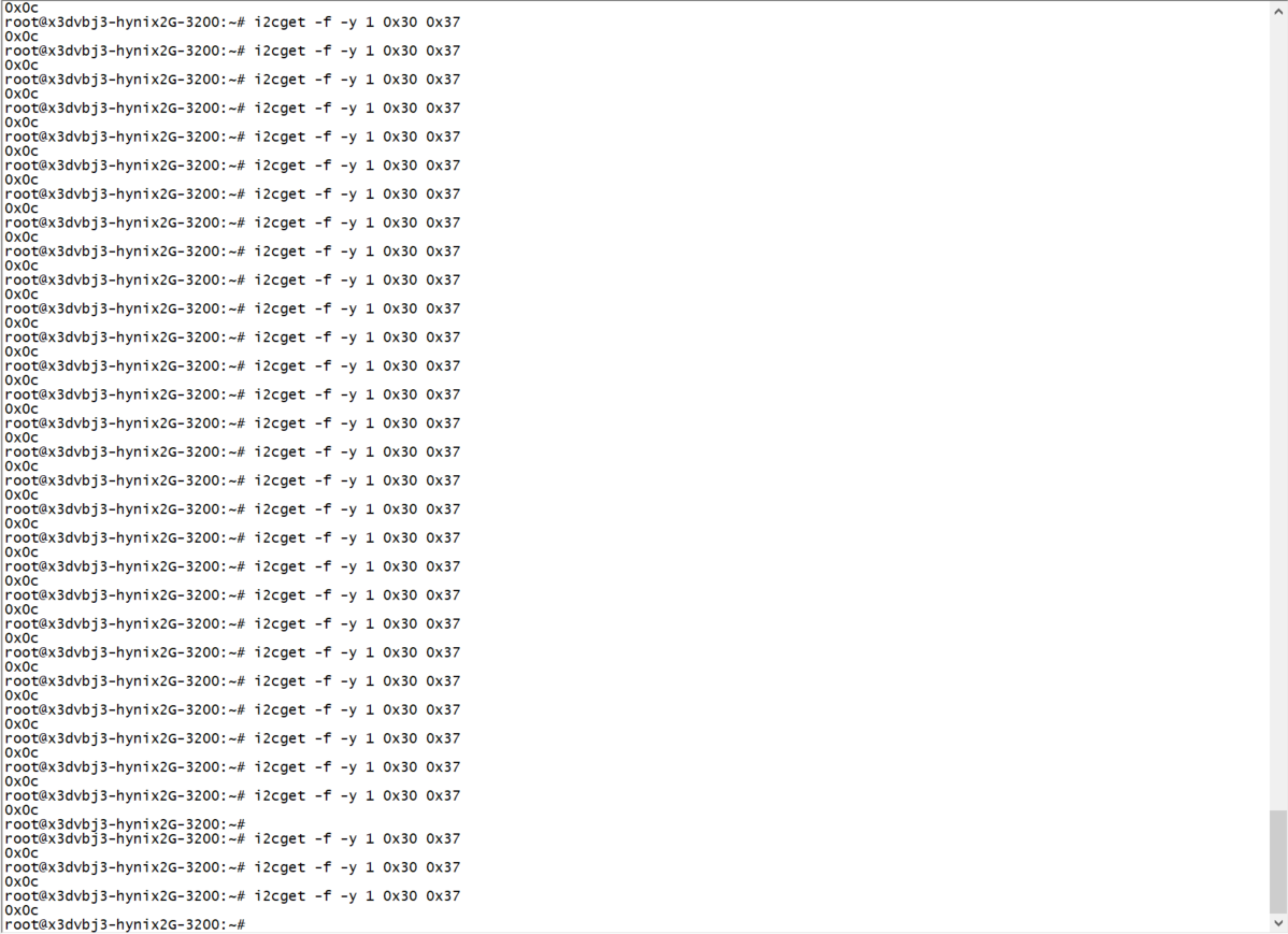

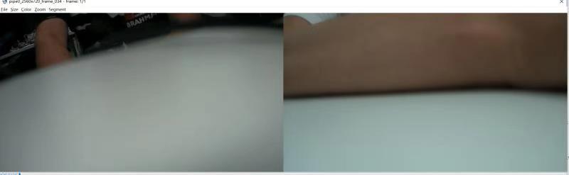

I'm using 960 with two 913 in Line-Concatenated CSI-2 Forwarding mode. Sometime we can get the correct video .But sometime,we saw synchronization errors in 960(Register (Address 0x37) = 0x0c) ,and we only got a video with frame rate about 27、28.
the resolution of the sensor working with 913 is 1280x720 ,data type is RAW10;
Two sensors are synchronizied by a framesync signal generated by 960.

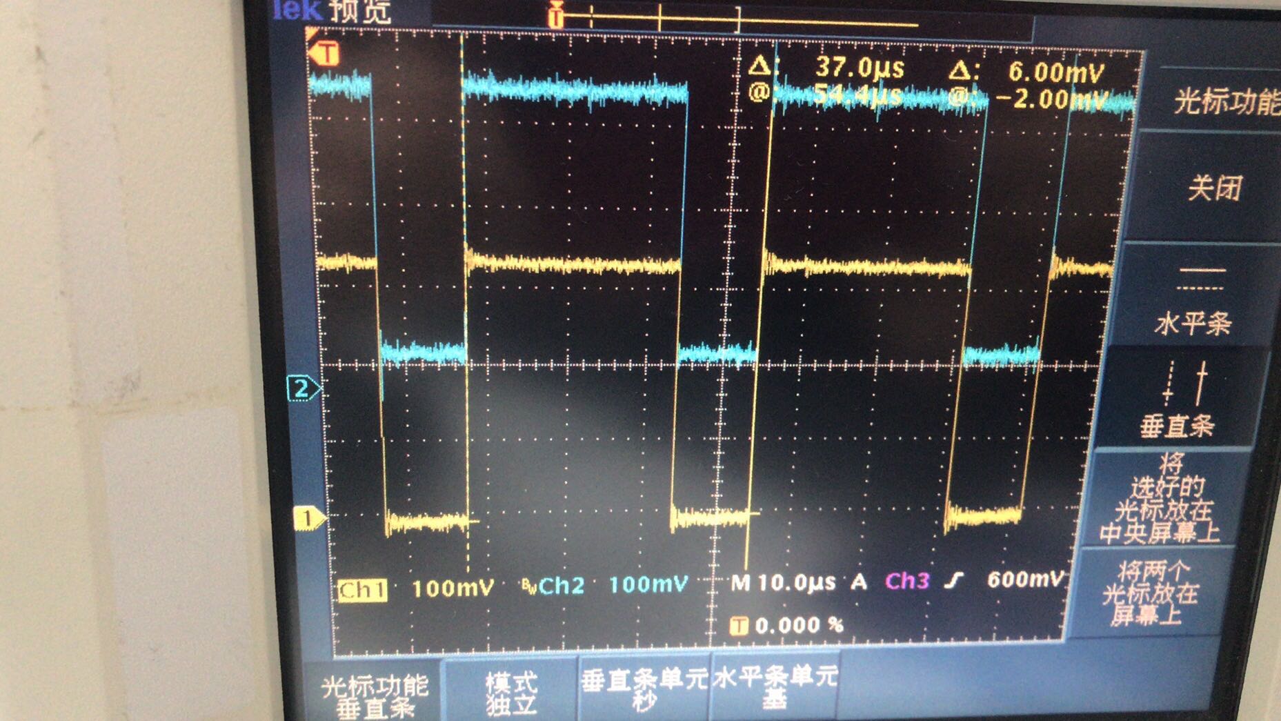

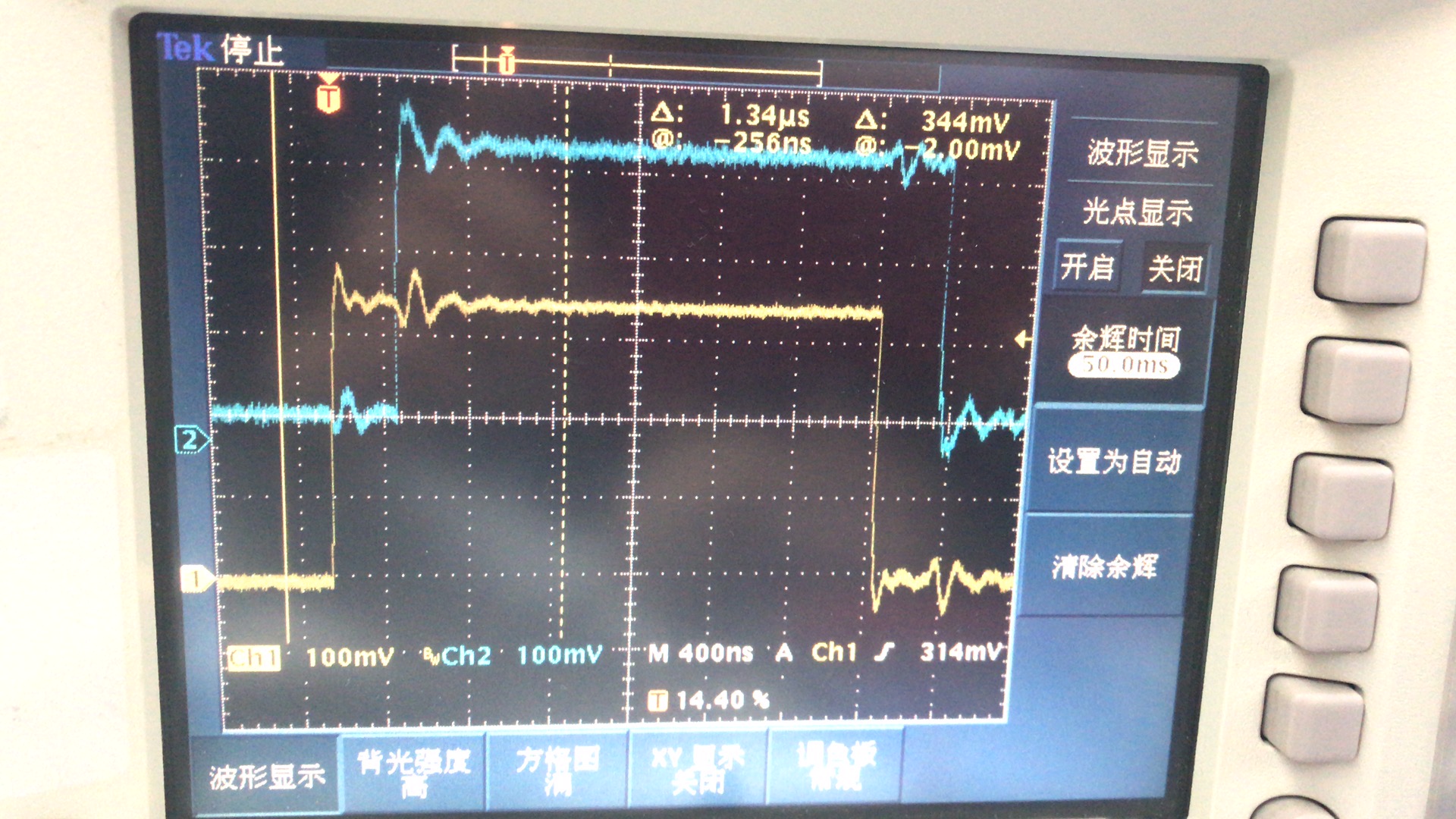

below are the two framesync signals output by two 913.
one HSync is faster than another about 340 ns . 340ns is much shorter than one line's time(37us)
So I'm not sure that 340ns is a acceptable delay? if yes ,than why I still got sync error occasionally?

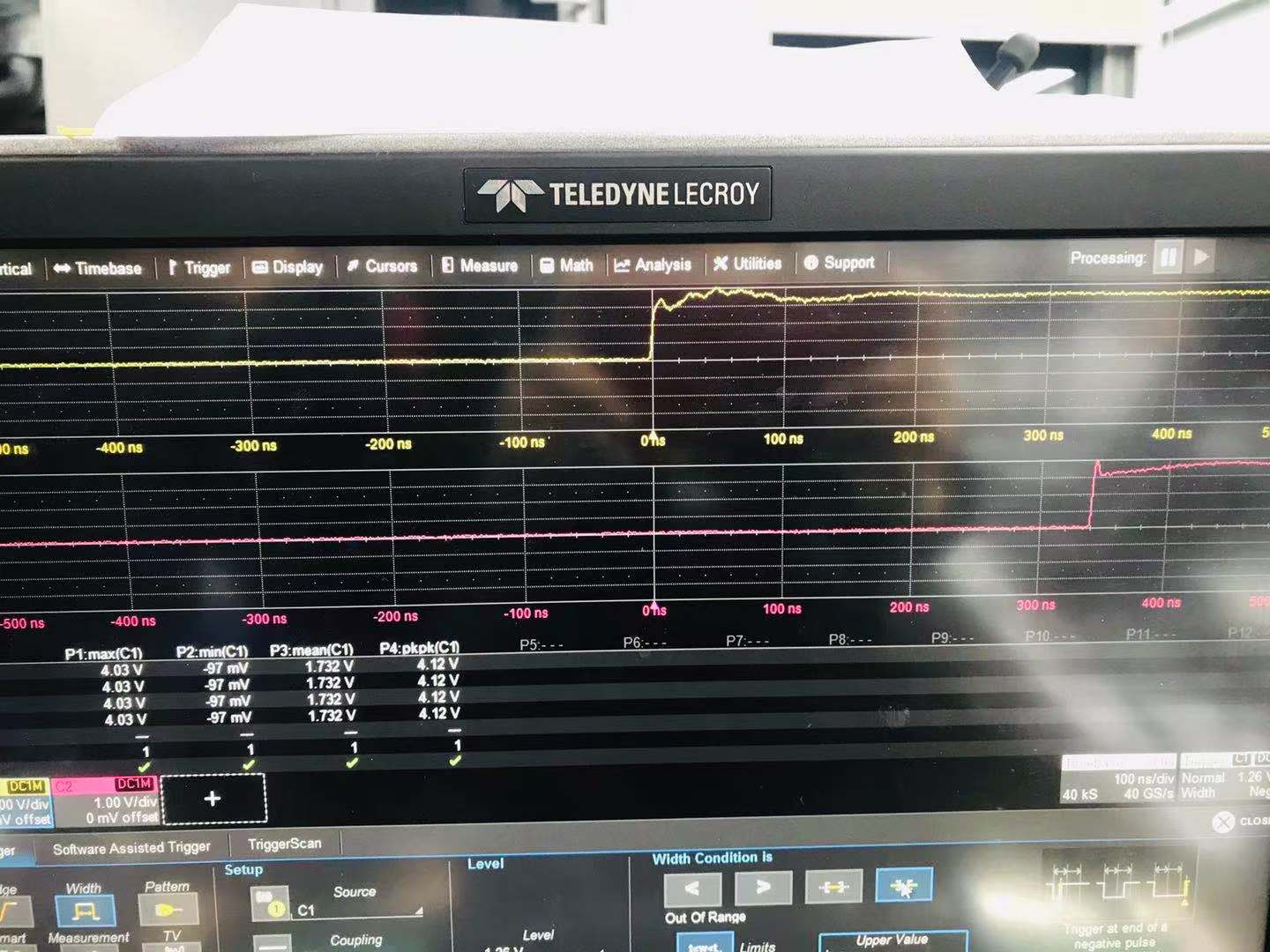

Two VSync signals , still 340ns delay
