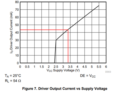

  • Hi Jonathan,
    I think Figure 7 may have been misread. A Supply Voltage of 3.3V on this graph maps to a Driver Output Current of close to 43mA at a load of 54-ohms. This seems more consistent with the expected values from the calculations using Figure 5.
    Figure 7 from THVD1451 datasheet:
    I hope this clarifies. Please let me know if I've misunderstood your question.

  • Hello TI-Support, hello Eric Schott,
    Still unsolved Problem.
    I did find this figure 7 at some time before.
    Using this figure I can calculate an effective impedance of 76,7 Ohm. Subtracting the 54 Ohm of the load resistance I get 22,7 Ohm for the internal resistance of the driver.
    When I will use an load resistance of 300 Ohm I will get a signal current of 10 mA.
    So far, so fine. Everything seems to be clear.
    Adding the quiescent supply current (driver and receiver enabled) of 3mA max., I get a total current of 13 mA.
    Also fine.
    But looking at the table of “7.6 Power Dissipation” (on page 9) there is a typical power consumption for 300 ohms load listed of 360 mW.
    Even if I take into mind, that this value is given for V_CC = 5,5 V, it will correspond to an supply current of 65.5 mA.
    And when I scale this power consumption (very rough assumption) linear with the supply voltage (i.e. all internal and external resistances will remain constant), then a supply current of 39.3 mA would be necessary for a supply voltage of 3.3 V.
    And this is my problem.
    Which power consumption ---- in terms of supply current is necessary for a load of 300 Ohms.
    12 mA (which will be fine) or 39,3 mA (which might exceed the capabilities of my power supply).
    And since both data values are calculated on the basis of the datasheet, and only one value can be right, there must be a failure somewhere in these calculations.
    Could you help me, to identify this error.
    Or could you at least provide the correct value for the supply current of this part.
    Operated with 3,3 V supply. Load resistance = 300 Ohms. And driver and receiver both enabled and working with about 30 Mbps.
    H.-L Reischmann
  • Hi Reischmann,
    I believe the main discrepancy between the different calculations we've been looking at here is the presence of AC current draw from communication. Figure 7  above shows the current draw of the device when no communication is present (D=Vcc). Because RS-485 uses a symmetrical structure for both logic values, every time there is a state transition on the bus, the driving transceiver will have to charge the bus capacitance from its previous state to its new desired voltage. The more frequently this is done, the more average current is required. This AC component is what is being added to the baseline calculations you've made to end up with the larger current values shown on other graphs and the power calculations on page 9.
    This AC component is primarily affected by the capacitive load on the bus while the DC component (which you have calculated using figure 7) varies most with the resistive load. To estimate what your total supply current needs are at a higher resistive load, we will need to separate out the AC and DC components.
    First let's look at the specifications for a 54-ohm load from the datasheet. To find the AC component, we can subtract the DC component (43mA found on the figure in my initial reply) from the total supply current needed for this load and voltage at a given data rate. From the figure below, we find this value to be about 58mA.
    Our resulting AC component is Total_54 - DC_54 = 58mA - 43mA = 15mA. Because this draw is dependant on bus capacitance, it will remain nearly the same as we change the resistive load of the bus. To find our new total at the same data rate, 3.3V, and 300-ohm, we can add your calculated DC component of 13mA to the AC component we just found. Total_300 = DC_300 + AC = 13mA + 15mA = 28mA.
    Please keep in mind that there are estimates that are based on the assumption that many variables remain unchanged. For instance, if the capacitive load of your system differs from what was used to create these specifications, the required AC current component will change. I'll also mention that if your power budget is tight and you don't plan to operate above 500kbps, THVD1410 will have better power characteristics due to less AC current being required at the slower slew rate used in this device variant.
    Let me know if this makes sense or if you have any questions on this explanation or these estimations.
    Eric Schott

  • Hi Hans-Ludwig,
    I believe I understand the discrepancy you're pointing out here. It appears that the DC cases do not line up between Figures 7 and 13. I believe this is because the specified behavior on graph 13 changes as it approaches the DC case. It's likely that the samples used to generate this graph were only taken in the linear region of this behavior and extrapolated to fill to 0Mbps. Therefore, this graph should primarily be used to estimate current consumption at operational data rates and not in DC cases. For DC cases, Figure 7 will provide more accurate estimates.
    For a more in depth analysis of this, we can see how the current consumption changes as data rates decrease by comparing Figures 13 and 19. Figure 19 with a range from 0kbps to 500kbps shows a near linear relationship with a slope of about 28uA/kbps (estimated between 100kbps to 450kbps). Figure 13 wich ranges from 0Mbps to 50Mbps also shows a near linear relationship, but with a much smaller slope of about 0.5uA/kbps (estimated between 5Mbps to 45Mbps). This shows that the relationship between data rate and supply current is not entirely linear through these ranges, especially close to the DC case. Electrically, we would also expect this. Fundamentally, the parasitic capacitances of the system along with the impedance of the driver circuit form a low-pass filter. Because we know that the current-frequency relationship in such circuits is not linear, we can expect similar behavior here.
    In summary, you point out a valid point: that the DC data point on Figure 13 is inaccurate, likely due to the extrapolation used to create the figure. However, the data point at 5Mbps is a measured value, so all other data points should be representative of expected behavior. There is no (significant) fourth contribution to supply current apart from what you have listed above. For estimating the DC case, I would recommend use of Figure 7 because this behavior was specifically measured at the given conditions.
    Eric Schott
