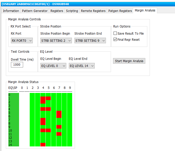

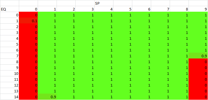

Hi team,
customer use 921/948 have display splash issue.
below is test result:
1. 1920x720-32@30fps, can display normally, don't see splash.
2. set 1920x720-32@60fps, display will splash. customer add a LED in LOCK pin of 948. In 60fps, the LED will blinked.
3. 948的MODE_SEL is :MODE_SEL0= Dual OLDI output (MAP_SEL = 1, OUTPUT_MODE[1:0] = 00)
MODE_SEL1 = (REPEATER = 0, MODE = 00, HIGH-SPEED = 5Mbps, STP)
Could you help to give some suggestions. one more infomation is that, with the same condition, 949/948 will be work properly, but 921/948 is not.
below is 921 dump reg and 948 reg value:
