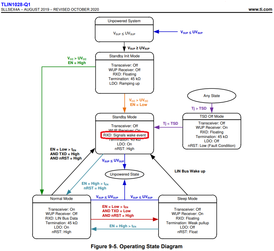

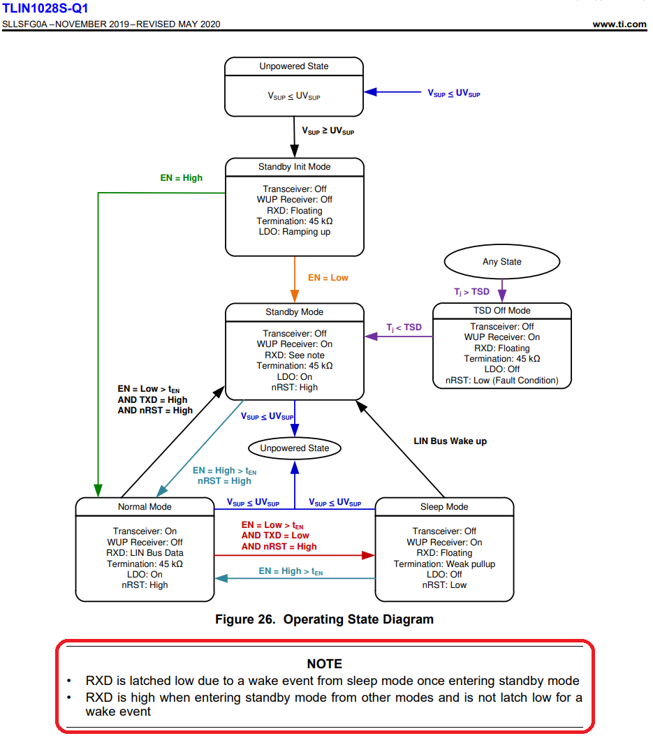

    During a transition into Standby mode from Normal mode, Standby INIT mode, or TSD Off mode, when a LIN bus wake event occurs, the RXD pin is latched low in the TLIN1028-Q1, while the RXD pin will remain high in the TLIN1028S-Q1.
    During a transition into Standby mode from Sleep mode, both devices pull RXD low and latch it in Standby.
    RXD Transmitter Behavior (Standby to Normal with TXD Dominant)
    During a transition from Standby mode to Normal mode with TXD dominant, for the TLIN1028-Q1, the RXD pin is floating but pulled high by an external pull-up resistor, meaning that RXD will not reflect the bus until a TXD transition to recessive. This is because the LIN transmitter is turned off until the first TXD transition to recessive, at which point the transmitter is turned on and RXD will reflect TXD and the LIN bus.
    During a transition from Standby mode to Normal mode with TXD dominant, for the TLIN1028S-Q1, a low-to-high-to-low pulse might be seen on the RXD pin within tMODE_CHANGE, not accurately reflecting the bus. As indicated in the figure above, RXD should be ignored during this time. This is because the LIN transmitter is turned on immediately and the dominant on TXD will be reflected on the RXD pin.
    State Diagrams
    You can also see this shown in the state diagrams for these devices.
    Here is TLIN1028-Q1:
    and here is TLIN1028S-Q1:
