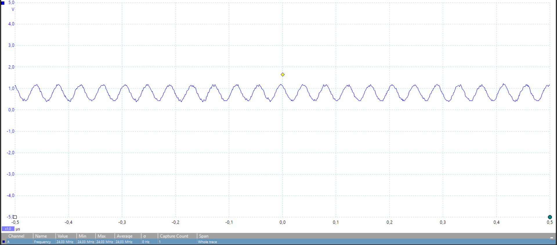

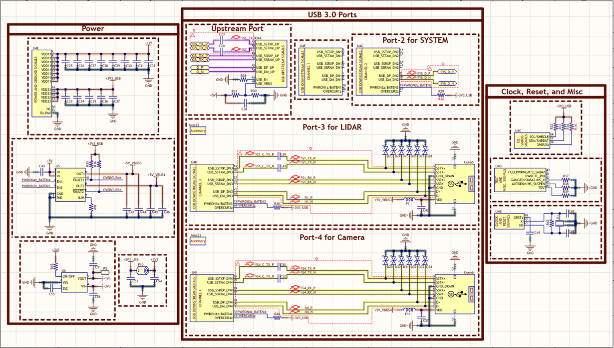

We are using Texas Instruments' TUSB8042A chip in one of our projects. We have received the schematic drawings of the TUSB8042A chip on the datasheet. The schematic page we created is attached. As indicated in the attached schematic, we use USB Hub's 2-3 and 4th ports. When we connect the TUSB8042A chip to the computer, we confirm that the chip is seen by the computer as 'Generic USB HUB' in the device manager. Also we cannot see the USB memory in any of the ports of USB_Hub on the computer side. 3.3V and 1.1V supply of the chip work smoothly. On the chip's datasheet, there is an inscription saying 'VDD must be at least 10 µs stable before VDD33'. The triggered state of the input supply for it is attached. 24Mhz crystal output externally connected to the TUSB8042A chip is attached. Do we need to do any programming on the basis of register in order to use the USB ports of the chip? I await your suggestions on this subject. I wish you good work.

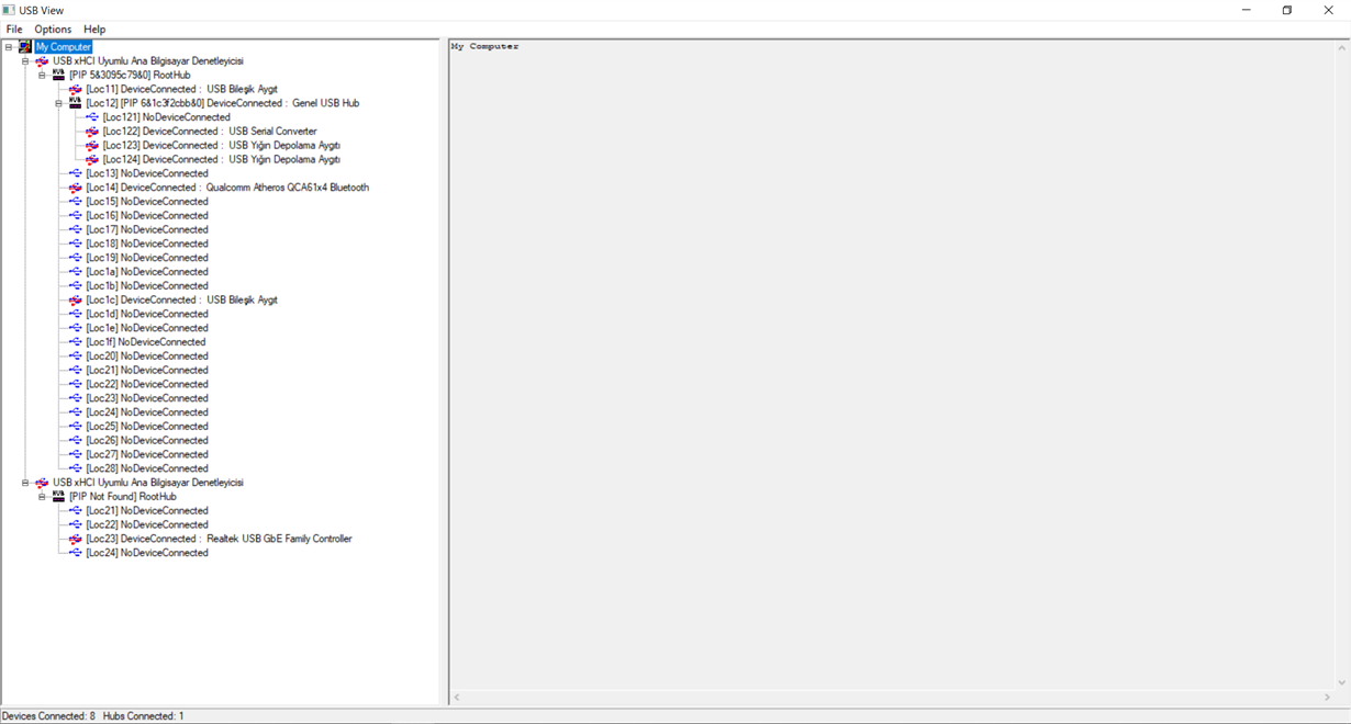

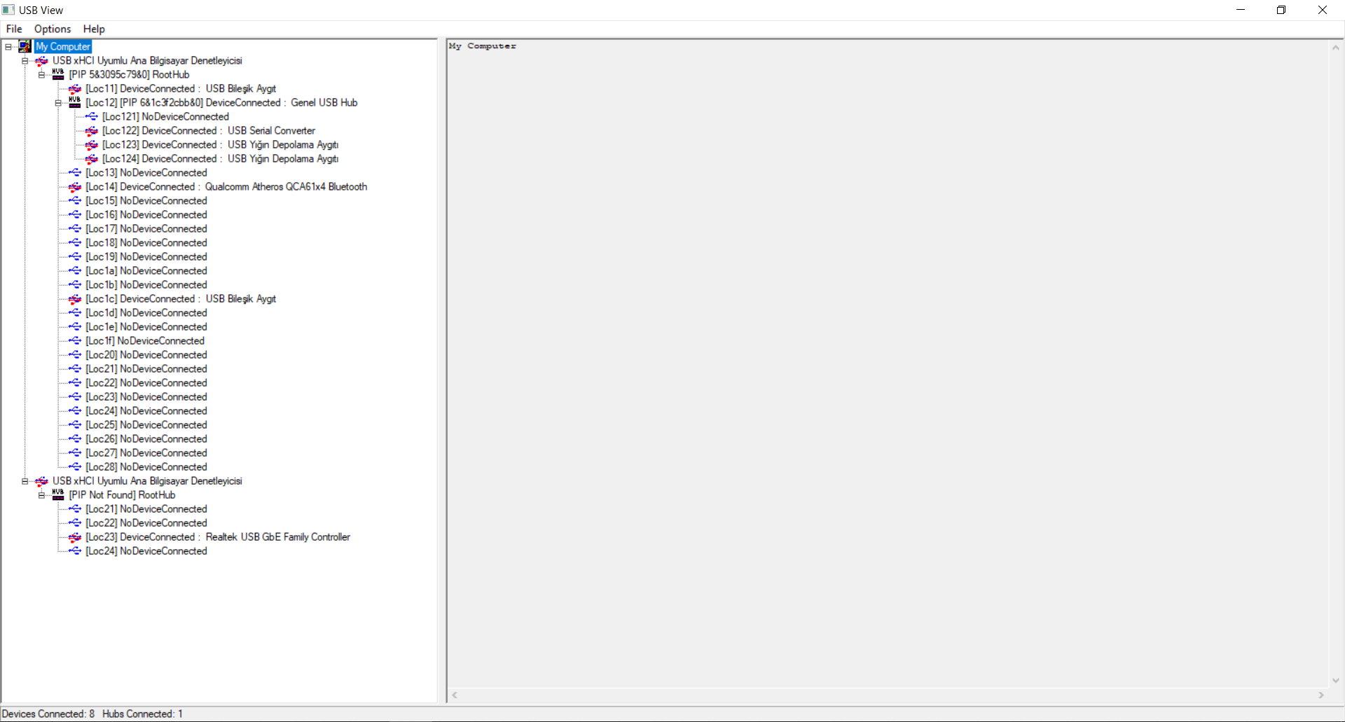

  • Hi JMMN,
    In response to your questions;
    1- I am using a Windows based operating system. Apart from that, the screenshot you want is attached. As seen in the attached picture, I can see all the ports I use actively on USBview.exe. Also, I still cannot see the TUSB8042A chip as a 'Super Speed Hub'. At first, I connected the PWRON4z_BATEN4 (Pin 32) and PWRON3z_BATEN3 (Pin 33) outputs of the downstream port in the schematic to GND in order to run the ports where I couldn't get any output before and I observed that the ports were working.
    2- Apart from that, when I connect the camera to the PORT-4 in the schematic, I can receive data from the camera at USB 2.0 speed. (The camera supports USB 3.0 speed.) We think that this may be caused by the protection elements in the Usb lines. For this, we wanted to share with you the BOM list of the schematic page of the TUSB8042A attached. We are curious about your views and opinions here.

  • Hi Furkan,
    The hub connections should look like this.  Please note that I'm using a slightly different model of hub so there are more USB 2.0 ports.  If the hub is not connecting at superspeed the downstream devices will all drop to USB 2.0 speeds.  I will check your schematic and BOM for possible issues.

  • Hi Furkan,
    The power control outputs of the hub default to active high, you should either use the TUSB2561 instead of the TUSB2560, or adjust the PWRCTL_POL pin on the hub.
    Can I see the schematic / BOM for the upstream port connection?
