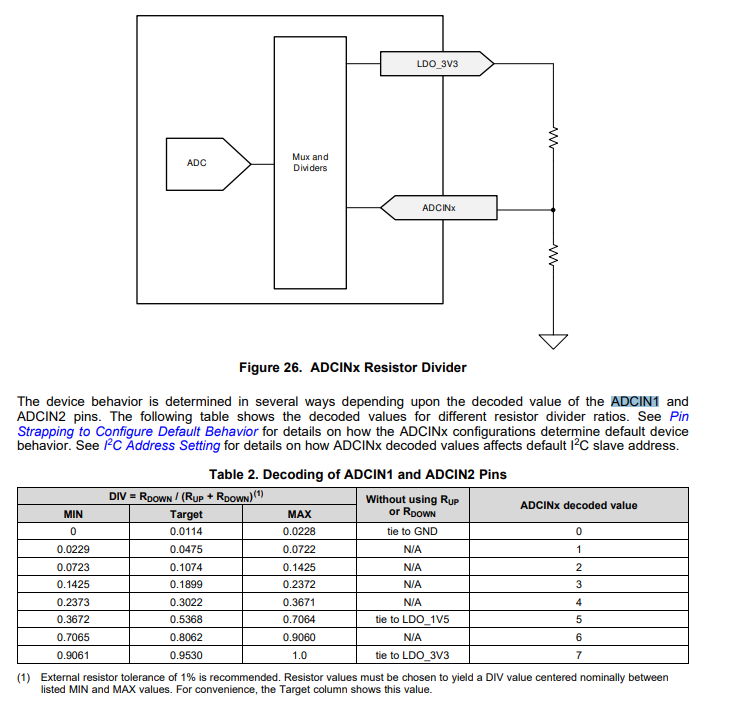

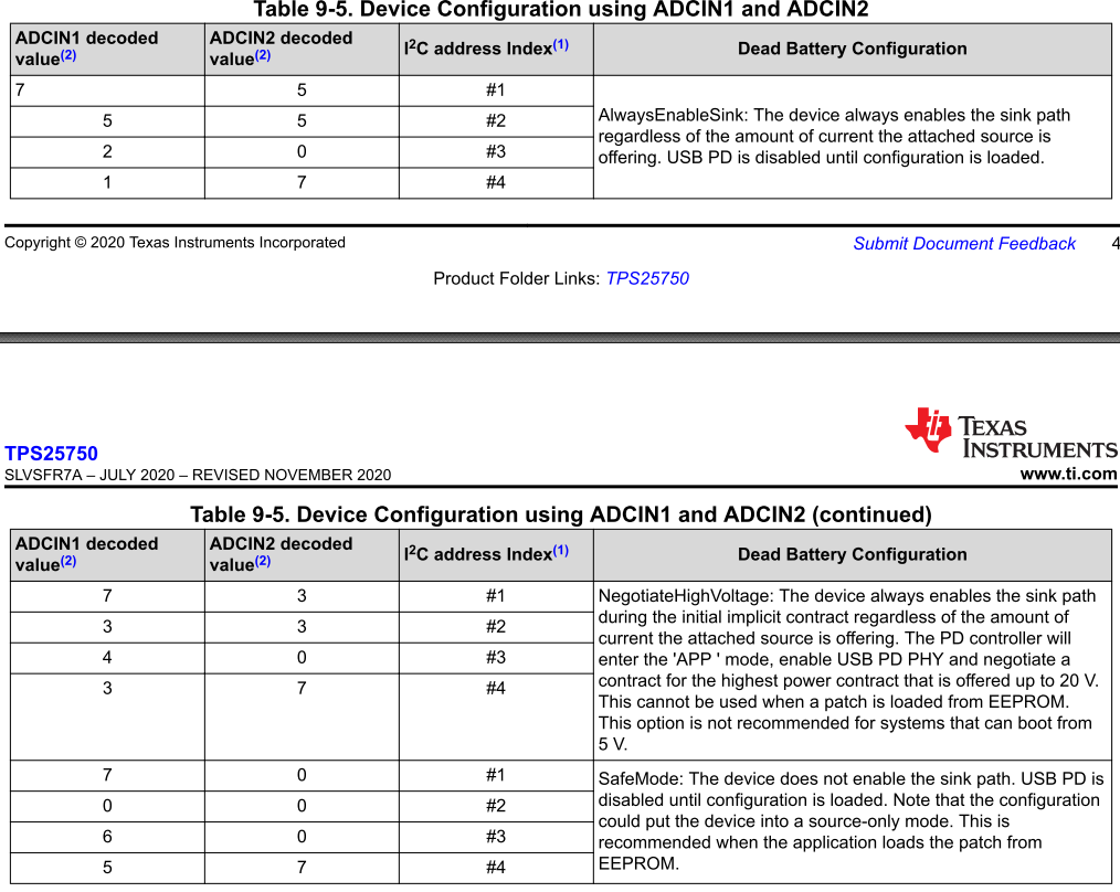

Hi team,
For TPS25750 application, device configuration is related with ADCIN1, ADCIN2 value; datasheet shows few description of this, could you let us know the relationship of ADC decode value and input voltage value?
For the 8bit ADC, how could read the exact data of the ADC?
Thanks and Best Regards,
