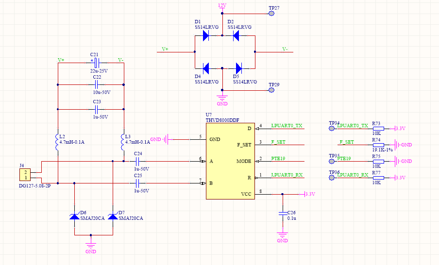

My customer have some problem for master-to-multislave 485 communication.
The baud rate chosen is 38400 with a 500-kHz load frequency and 19.1K resistance for the F-SET pin. The inductance of the slave is calculated with 4.7 mH by 32 nodes, but only 7 nodes are used for the experiment, the capacitance is 1 uF. The lab procedure has a terminal resistance of 60 Ω, and the following problems occur.

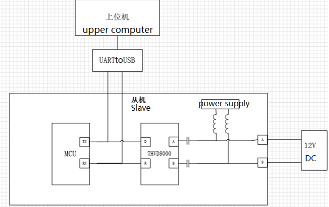

1.While verifying the program (only powering the host or one of the slave), with the THVD8000 chip, the upper computer does not interact properly with the host or the slave via the URAT to USB, measuring the TX and RX of the MCU, both pins are always at high level (If it is caused by no input on ports A and B?). And the upper computer will communicate properly after the chip is removed.
2.It is interrupted while the master and slave communication is in progress, and in good cases it can be communicated for a few seconds. The RX and TX sides of the slave were tested with an oscilloscope and it was observed that the slave received a host signal and did not respond to the host.

    2.When the slave program is verified separately. The program for the slave is: the slave is in the receiving state all the time and sends the data back after the slave receives the correct data. While welding on the THVD8000 chip, they sent the data to the slave using the upper computer, which should have sent the same data back, but the slave did not respond, and then they removed the THVD8000 chip, sent the data, and the slave would return normally. So they suspect there is no signal input between the A B ports, which causes a high level between TX and RX, which affects communication between the upper and slave MCUs. (This problem was discovered during the validation process, but does not affect the subsequent master slave communication, they would like to ask why this is the case) The connection diagram for the slave and the upper is as follows:
    3.While multi-slave communication is taking place, it is not that the host is unable to receive the signal, but when communication is taking place, there is a problem at one node where the slave does not send a signal back to the host. The situation is as follows: The host program sends the data to the first slave, after the host gets the data back from the slave and determines that the data is correct, then sends the data to the next slave, so that it always circulates back to the seven slave, and if the data returned from the slave is wrong, the host gives the slave again, the host sends the same data, and if the host does not receive data back from the slave, the host remains in the receive state, stopping communication. So it can be judged that the communication was lost because one of the slaves did not send back data to the host. they want to know what the problem is.

    Thanks for your explanation, which helps me understand the system. However I'm still not sure how the data is sent to the slave without the THVD8000? Is the digital logic directly sent over the capacitor? I would also like to confirm if the point to point communication (one master and one slave) works fine.
    Hao
  • Hi Hao,
    1.As the picture shows, upper computer send the data to slave's MCU through USB2UART converter. Without the THVD8000, it works normal, but abnormal with THVD8000.
    2.It works fine when point to point.
