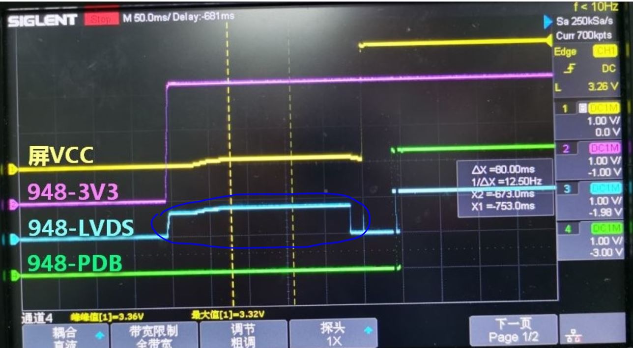

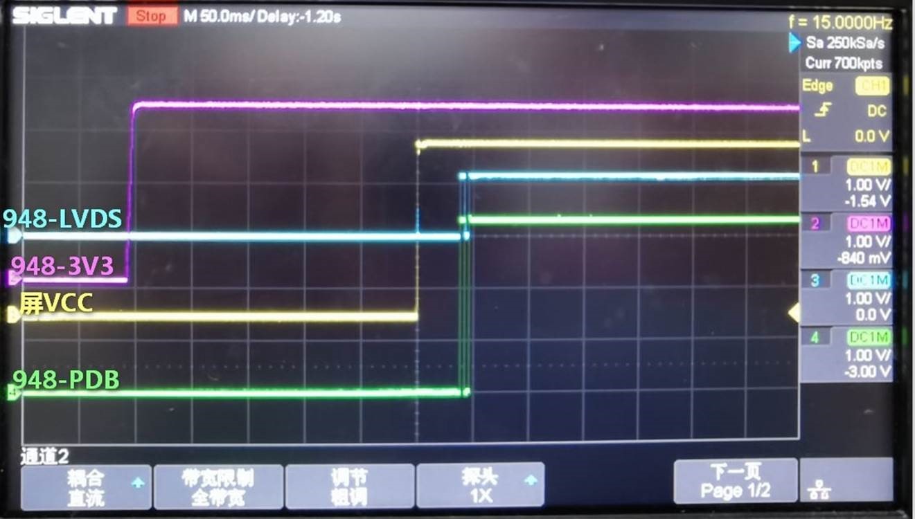

Hi team
Customer tested UB948 and found in some pcs there is unexpected voltage platform in OPLDI output(ch3) before PDB ramp up (pic 1), while in other pcs(in the same board) the voltage keep zero before PDB ramp up (pic 2).  Also, in the unexpected case, they disconnected the link between the display panel. The voltage platform still exist. They wonder whether this voltage platform before PDB ramp up is normal? if no, what's your suggestions to dig out what does this voltage platform come from?   Thanks!
note: ch1 is display panel Vcc
