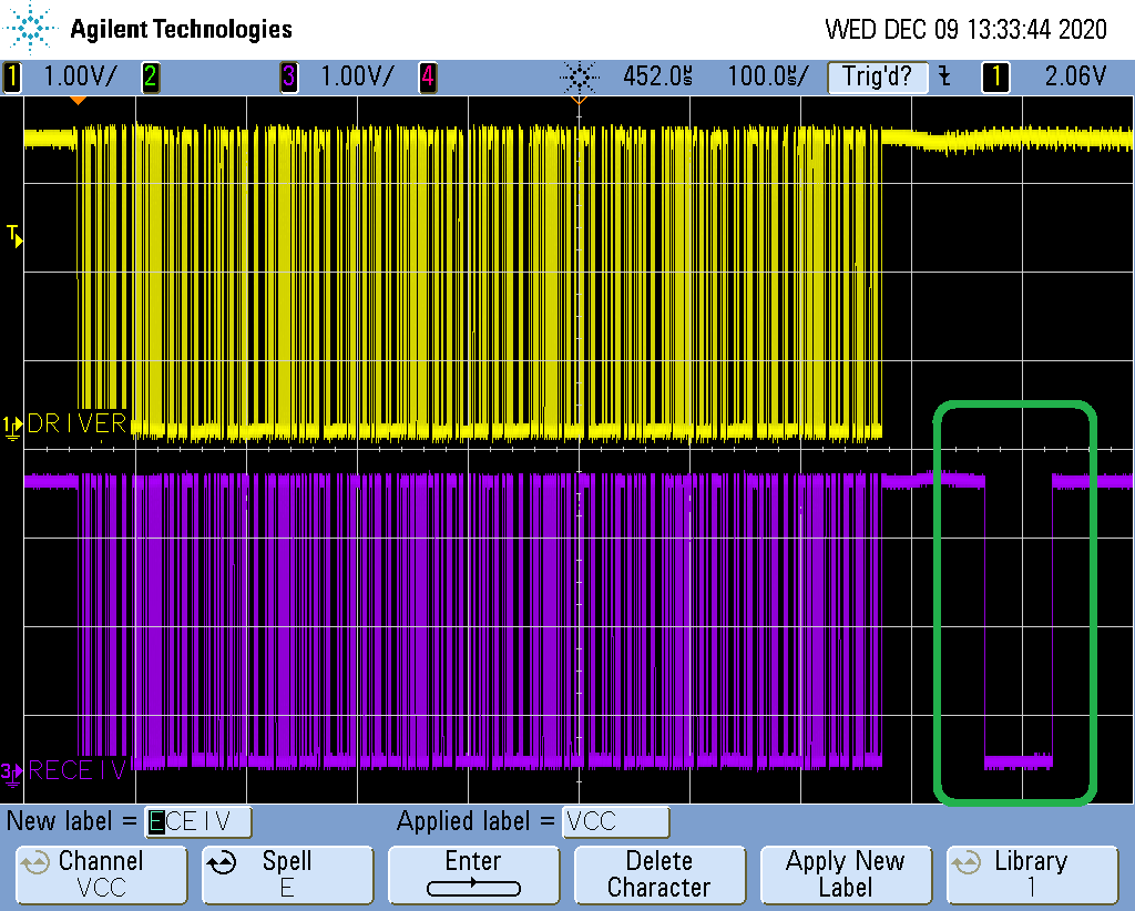

We try to implement RS485 power over bus with SN65HVD75 using TIDA-00527 design reference.
The system data rate is 921600bps with 3m cable length. But R output still pull low around 60us in the end.
How to prevent pull low in the end? Do you have any suggestion to solve this issue?
I attach pcb schematic and a oscilloscope graph with D of SN65HVD75 of DRIVER and R of SN65HVD75 of RECEIVER.

    Back to the issue, can you capture the waveform of the bus when R was low? It might be due to the bus noise or poor signal integrity. The schematic looks good to me. However I'm not sure how well the 120Ohm termination matches the cable impedance.

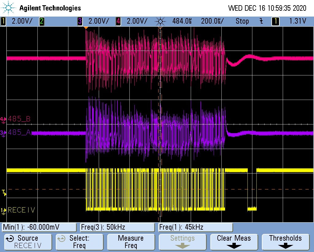

  • Hi.
    This are the signals: R -> Yellow, 485_B -> Magenta and RS485_A -> Violet
    Best Regards
  • It looks like the glitch is due to the different setting time of the wires. Can you try a different termination value to check the difference? If not already used, is it possible to apply twisted wire? Another thing to tweak is increasing the common mode cap (C8) value. Again, I think it's worth trying THVD8000, which has taken such issues into account in design.
