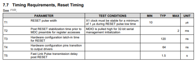

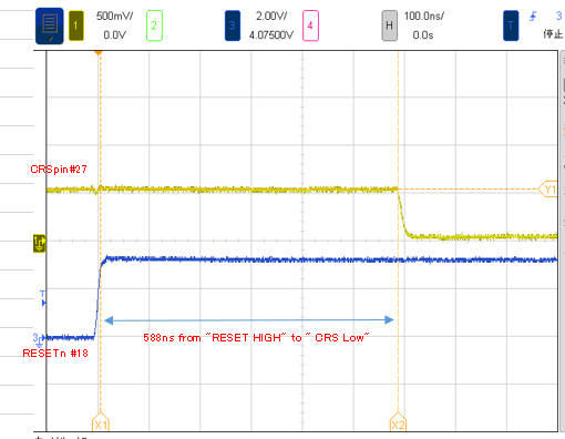

After the Power up on DP83822I, it takes 588ns from RESET's de-asserted to CRS pin's low. According to datasheet, this time is T3 + T4 = 184ns (Typical). It seems too long. So my customer worries whether it is any issues because 588ns is too long. Please let us know your opinion.
Waveform is as follows:

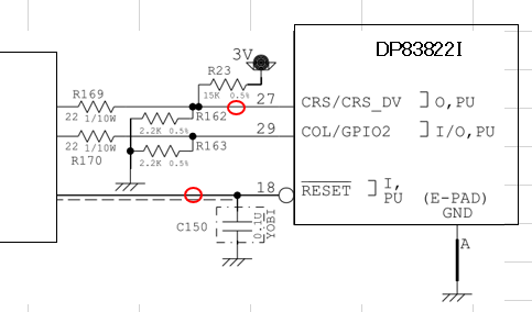

Schematics is as follows:
Datasheet is as follows:

    Can you check the time it takes from RESET de-asserting to when RX_CLK comes up? Can you do the same for any other pin? I would like to know if this is something you see on multiple pins or just the CRS pin.
    Adrian Kam
  • Hi, Adrian-san,
    The following pins are changed.
    • RX_ER#28 : 570ns   (0.142V→0V)
    • COL#29 : 558ns   (0.150V→0V)
    There is no data of RX_CLK pin.
    Under the above information, is it possible to confirm whether this device is no issue?
    Thanks and best regards,
    M.HATTORI.
  • Hi Hattori,
    Can I take a look at the entire schematic? You can send it to me through email instead of posting it here as well.
