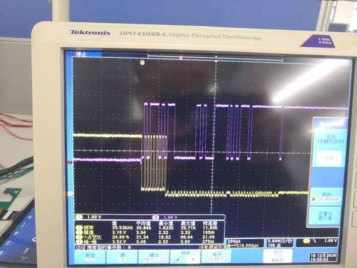

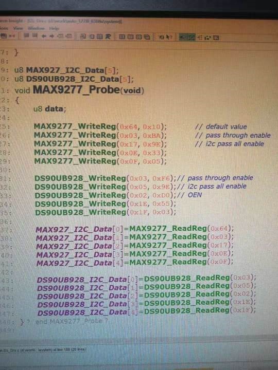

customer have issues about 927/928 I2C mapping. they found that in 927 side, the SCL will be pulled to low sometimes, below is customer reg setting and I2C waveform:
1. reg setting
2. 927 I2C waveform,  yellow is SCL, Pink is SDA
3. 928 I2C waveform
issue:  927 SCL will be pull down and difference with 928.
