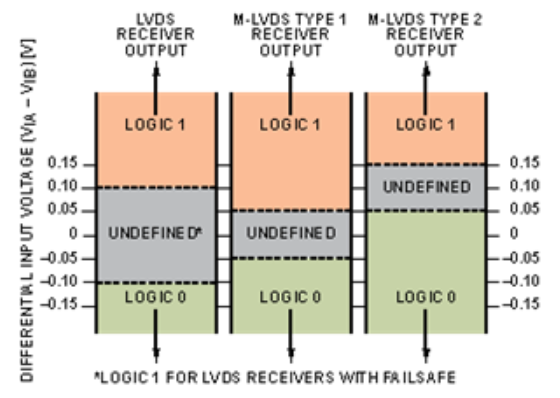

I am wondering if there is compatibility of the SN65MLVD207 with LVDS and if not, are there any suggested solutions to providing such a conversion? I currently have a test adapter that uses this transceiver to communicate with devices and am looking to see if there an external solution to adapt/convert it to communicate with an LVDS device.
