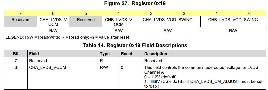

Dear team,

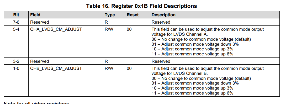

Recently my customer did the EMC test of our chip. At the beginning, the test can't pass. They try to change 0x1B register value, but no use. After setting 0X19[bit6=1], the test can pass. Could you please tell me why we create 0x1B register? What application do I need to adjust this register?
