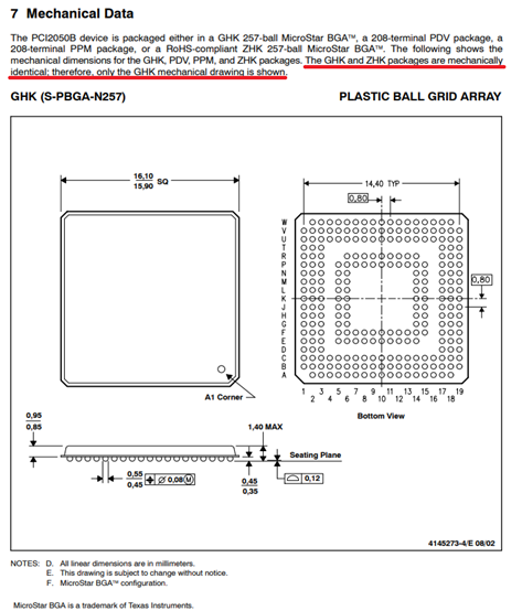

Part Number: PCI2050B
Dear Technical Support Team,
Are PCI2050BZHK and PCI2050BZWT the same pin configuration?
These pin pitch and size are same , however number of pins are small.

TTD
Please refer to Table 2-3 and 2-5, the GHK and ZHK have the same pin configuration. There is no ZWT package available for the PCI2050B.

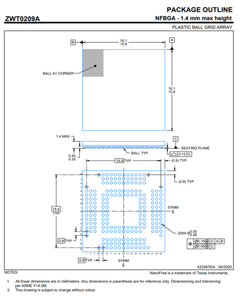

Hi David
Thank you for your reply.
I see this e2e and pdf for ZWT(redesigned ver).
https://e2e.ti.com/support/interface/f/138/t/963685
ttd
TTD
The pinout will still be the same between the two packages.

Hi David.
The package of PCI2050BZWT means ZWT0257A?
this pdf has only ZWT0209A.

TTD
I confirmed we will release the PCI2050B in the ZWT257 package.
