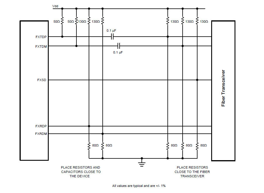

In 100BaseFX mode, can you tell me what the receiver common mode voltage and min/max differential swing is for the DP83620?
We have an application where we are ac coupled to an optical module driving CML with ~ 400mV single end swing.
Are there any input jitter or pulse symmetry requirements on the receiver in 100BaseFX mode?
