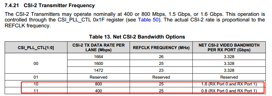

When I set the sensor data input of DS90UB953 to 400bps,The output of the DS90UB954 set to 400bps cannot display the image,I set DS90UB954 to the output of 800bps to display the image normally.
What is the reason and what parts need to be set up?

    pls make sure the design follows up the 953/954 design request, and check your issue step by step. it could be 953's input issue, or 954 output setting issue or the on-board SOC issue. anyway you should check it clearly.
    1. what is the input signals to 953
    a. CSI2_CLK signal, pls provide detailed clock freq.
    b. how man data lanes are used?
    2. how to set 954's output?
    a. how to set the 400Mbps? pls follow up the d/s request (timing should be updated since it is not 800Mbps, this is described in d/s

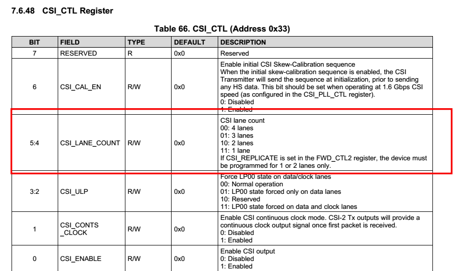

    b. how many data lanes are set?
    3. question: what error is reported when set 954 at 400Mbps? is it SOC issue followed with 954?
    =>2 lanes

    1. if the csi2 data from 953 csi2 port is 400Mbps/lane *2lanes, the ub954 can be set as 400Mbps/lane *2lanes with 25M ref. clock and +/-50ppm. pls make sure the imx327 output clock, it is better if you can provide the test plot
    2. for 400M setting inside 954, pls ignore the REF_CLK_MODE. You just set the CSI2 PLL to select 400Mbps and fine tune the dphy timing parameters.

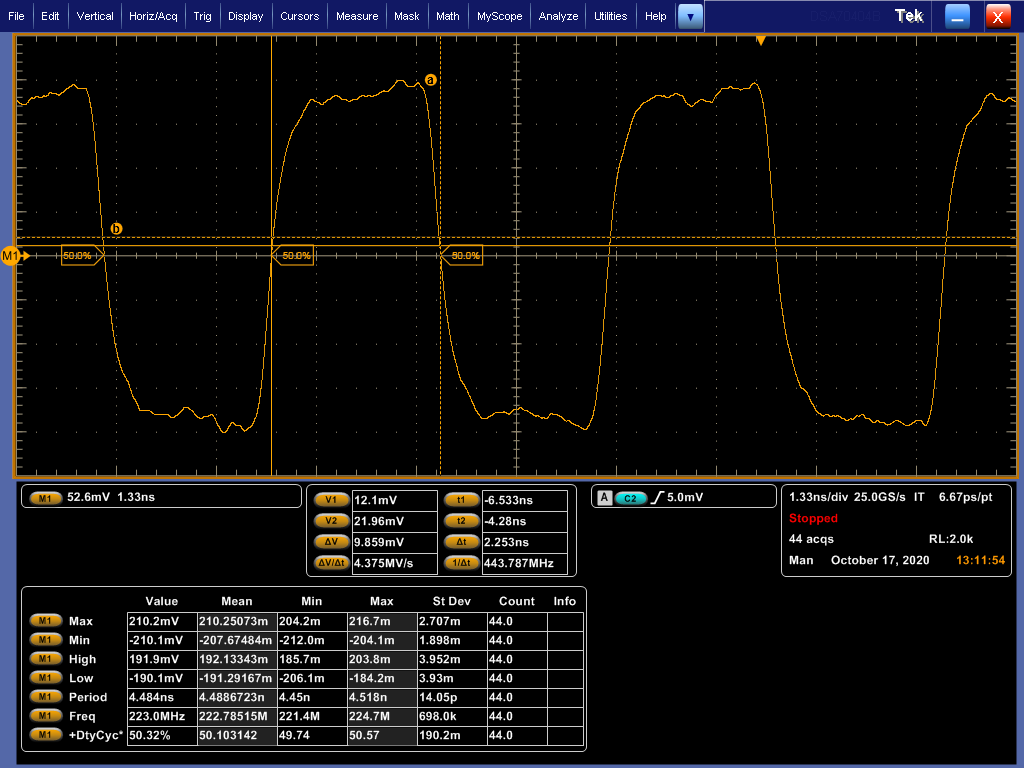

    =》The IMX327 output clock is 222Mhz

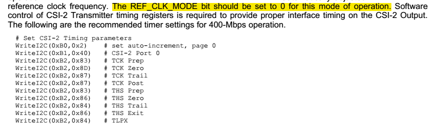

    =》what should the REF_CLK_MODE be set if setting 400Mbps? which charter of the datasheet  does the dphy timing parameters should refer to when set 400Mbp、800Mbps or other rate?

    The test waveform is as follows.
  • in summary:
    1. the sensor output csi2 rate should be <=400Mbps/lane * 2lanes if you want to enable 954's 400Mbps/lane *2lanes mode
    2. to set 954's 400Mbps mode, you refer to reg. 0x1F to change the rate also fine tune the timing which  is pasted by you as example in d/s.
    =》so,with our design where the  Sensor output cis-2 rate 445Mbps/lane*2, should we enable 4's 800Mbps/lane *2lanes mode?
    =》how to set the 800Mps timing ?the d/s only show the timing with 400Mbps

  • hi,
    1, yes. in your case, 954 can't be set as 400Mbps/lane x2lanes
    2. for 800Mbps, you don't need any setting on the timing, the default is designed for 800Mbps.
