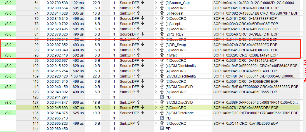

Description of the problem phenomenon:
Power on the product first,Then use type_c to insert the unbooted Apple computer,
The product charges the Apple computer. Then the Apple computer automatically turns on,
Apple computer cannot recognize the product after booting(problem)
, but the product will still charge the computer.
The product after plugging and unplugging,The computer can recognize the product.
The file is PD log
MACBOOK PRO 2018.rar
The current preliminary analysis is that dr_swap failed, as shown in the figure below:
thanks

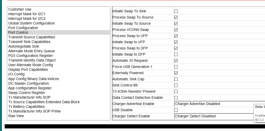

    I am not entirely clear about the problem here. Are you attempting to charge the Apple computer with our PD?
    Are you using an EVM to do so? Have you configured the Port Control Register (0x29) "Charger Advertise Enable" ?
    Kedar
  • Hi Kedar,
    My problem is that my product can't be recognized by Apple computers。
    this is my configuration for Port Control Register.
    thanks
    Since you have selected "Initiate Swap to UFP" the PD controller should have retried the DR_Swap message.
    After you unplug and plug, you mentioned, the issue is not observed. Can you share the TotalPhase logs for the pass case?
    Kedar

  • Hi Kedar
         From the logs,Dr Swap does not accept, only shows wait.This results in no data role exchange, so the product cannot be recognized
         Please continue your assistance. Thank you

    pass step:
    1. The Apple computer is on.
    2. Use type c to connect DOCK to Apple computer.
    result . Apple can recognize the product.
    Below is the PD log and  FW debug trace.
