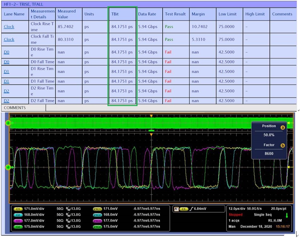

Hi:
   We do HDMI 2.0 SI measurement, but we found a problem, My product is Intel RKL-S platform. TBit only half compare with the CML-S pass report. We do HDMI 1.4 SI measurement and it’s pass. We do all HDMI SI measurement with RKL-S ES-2 CPU and ES-2 PCH. Does it related the CPU version? Or any setting should be checked? Please help to check, thank you.
RKL-S configuration (fail)
Intel DDI + TI SN65DP159RGZR
    What resolution are you using for the HDMI2.0 compliance testing?
    Are you using pin-strap mode or I2C mode? Please read the DP159 register 0x0B and make sure the TX_TERM is set to 75-150ohm and TMDS_CLOCK_RATIO_STATUS is set to 1 for HDMI2.0.
    If the TX_TERM and TMDS_CLOCK_RATIO_STATUS are set correctly, please toggle the HPD_SNK next (High-Low-High) next.

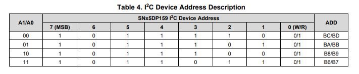

         I use Intel RKL-S QS CPU to verify this issue again. But the TBit rate still wrong. I set the resolution to 3840 x 2160 at 60Hz and the link is done. But when I try to switch the resolution setting, the waveform will not be changed. I guess the EDID communication is something wrong. Would you please teach me how to check the register 0x0B? If I use RW, how to check it? Or any tool could be used in Win10 ? Thank you.
    The DP159 registers are accessed through the SCL_CTL and the SAD_CTL pins. In the pin-strap mode (I2C_EN pin = 0), the registers are read-only. In the I2C-mode (I2C_EN = 1), the registers are read/write. You can use a standard I2C controller to access the registers.
    In the I2C-mode, please refer to this app note on the registers configuration:
    The I2C address is set by A0 and A1 as shown in the table below. Depending on the pullup/pulldown on A0 and A1, the address can be 0x5E, 0x5D, 0x5C, or 0x5B.

  • Hi David:
         I found one thing when I do the HDMI 2.0 test. That is when I set 3840x2160 at 60Hz, ready to do HDMI 2.0 test. If I change the resolution of the HDMI port,
    the waveform shows on scope will never change. Does it mean the EDID communication is not work anymore? Thank you.
    When you change the resolution, could you toggle the HPD and see if the waveform changes?
    David
  • Hi David:
        Yes, we also try toggle HPD to make waveform change, but it doesn't work. It seems Intel VGA driver or firmware doesn't set register 0x0B? Thank you.
    As part of discovery, the source reads the sink’s E-EDID information to understand the capabilities of the sink. Part of this read is HDMI Forum Vendor Specific Data Block (HF-VSDB) MAX_TMDS_Character_Rate byte to determine the data rate supported. Depending upon the value, the source writes to sink address 0xA8 offset 0x20 bit1, TMDS_CLOCK_RATIO_STATUS. The DP159 snoops this write to determine the TMDS clock ratio and thus sets its own TMDS_CLOCK_RATIO_STATUS bit accordingly. If a 1 is written, then the TMDS clock is set to 1/40th of TMDS bit period. If a 0 is written, then the TMDS clock is set to 1/10th of TMDS bit period. The DP159 defaults to 1/10th of TMDS bit period unless a 1 is written to address 0xA8 offset 0x20 bit 1. When HPD is deasserted, this bit is reset to default values. If the source does not write this bit, the DP159 will not be configured for TMDS clock 1/40th mode in support of HDMI2.0a.
    If you do not see the source writes to the sink address 0xA8 offset 0x20 bit 1, then this is a source driver issue.
    If you do see the source writes to the sink address 0xA8 offset 0x20 bit 1, but the DP159 TMDS_CLOCK_RATIO_STATUS is not set, then this may be a DDC snoop issue. You can force the TMDS_CLOCK_RATIO_STATUS to be a 1 for HDMI2.0 by writing a 1 to DDC_TRAIN_SETDISABLE first, and then write a 1 to the TMDS_CLOCK_RATIO_STATUS bit.
