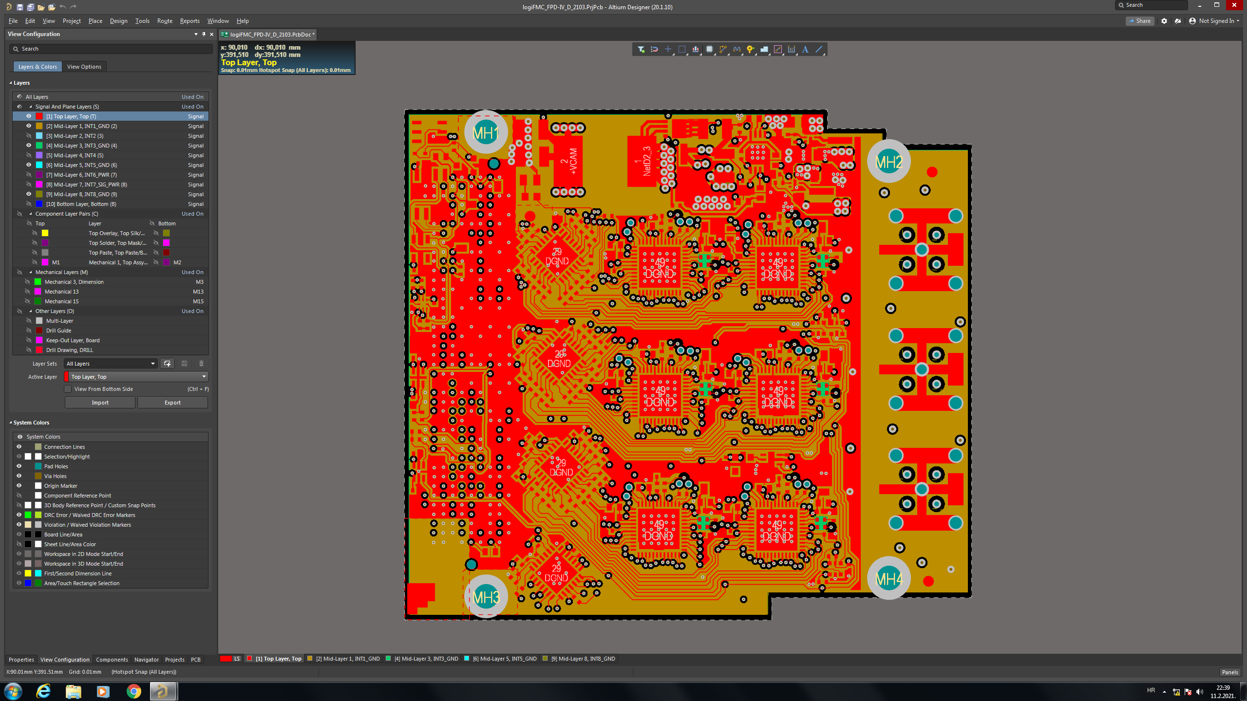

  • Hi Casey,
    Thanks again for your assistance.
    We were also suspecting that the problem might be related to FPD link PCB trace impedance or some impedance discontinuities that may be present. Yesterday I did an experiment using deserializer where one channel works well and the other does not. I connected 1m long, 50 ohms coaxial Leoni Dacar 301 cable directly to deserializer effectivly bypassing the PCB trace completely (100nF DC blocking capacitor was, of course, present).. PCB trace DID NOT not remain connected to DC blocking capacitor so no stubs were present. I connected the same cable and imager first to the faulty and than to the good channel. No major differences were found comparing to the PCB trace. Bad channel was still bad, and good channel was good. I attached result obtained by our margin analysis routine (The original TI's MAP produces the same results - Not sure if attaching the file was successful). I am aware that both channels satisfy minimum requirements but we are concern about the obvious huge difference between them. Do you have any idea what might be causing such behavior besides impedance mismatch? I also attached image that contains TOP and BOTTOM layers of our PCB. Schematic is basically the exact copy of the example schematic shown in device's datasheet. I am aware that the PCB layout is not perfect, but if the PCB was the main culprit, I would somehow expect that both channels would be influenced without some significant difference between them.
    Goran

  • Hey Goran,
    Can you please put some labels on your picture above to where the FPD routing is? I can't really tell which way the chip is rotated based on this picture and the net labels don't give my info.
    Have you also checked the schematic components against the datasheet? i.e. power supply decoupling caps, ferrite beads?
    Casey

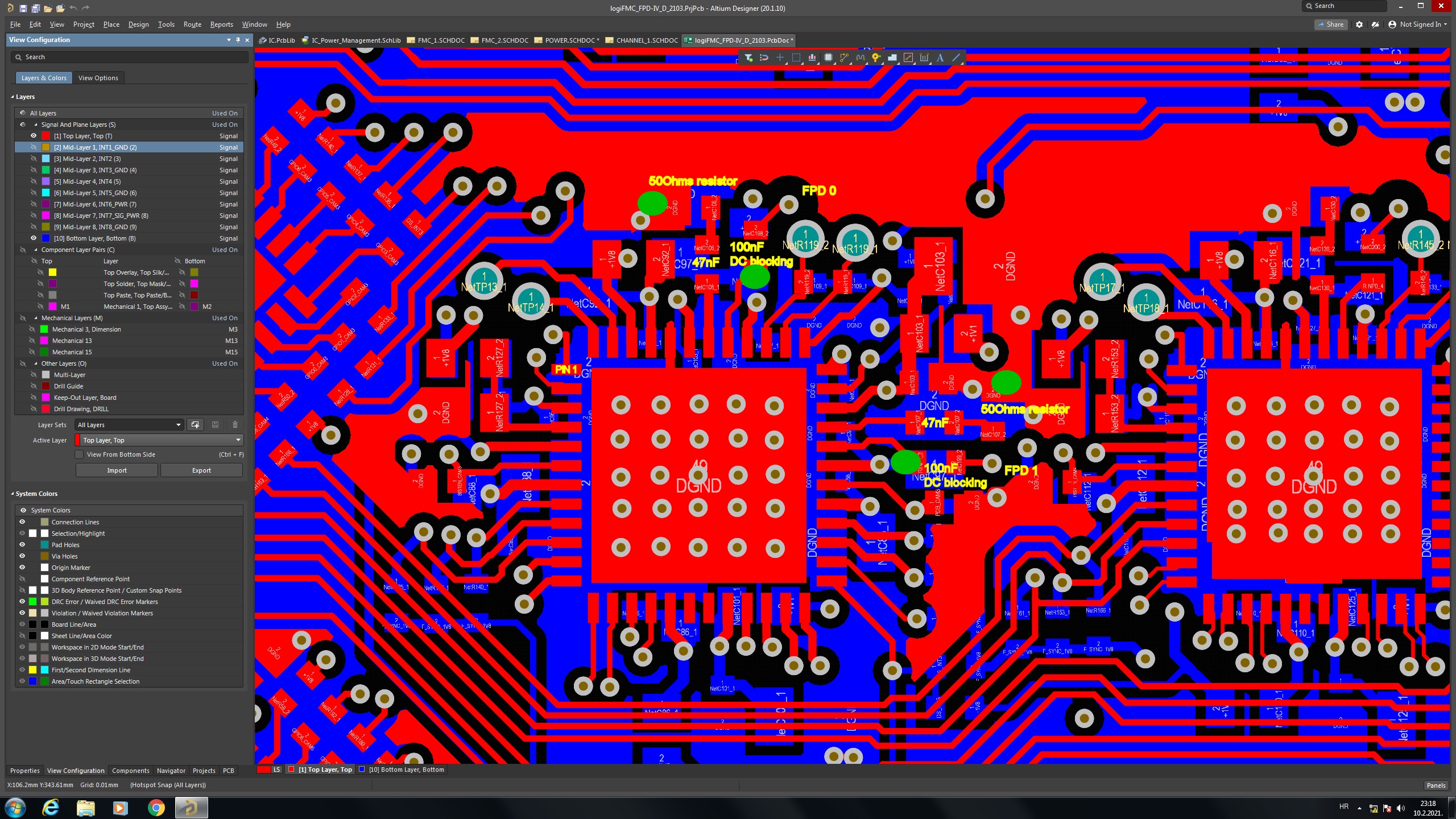

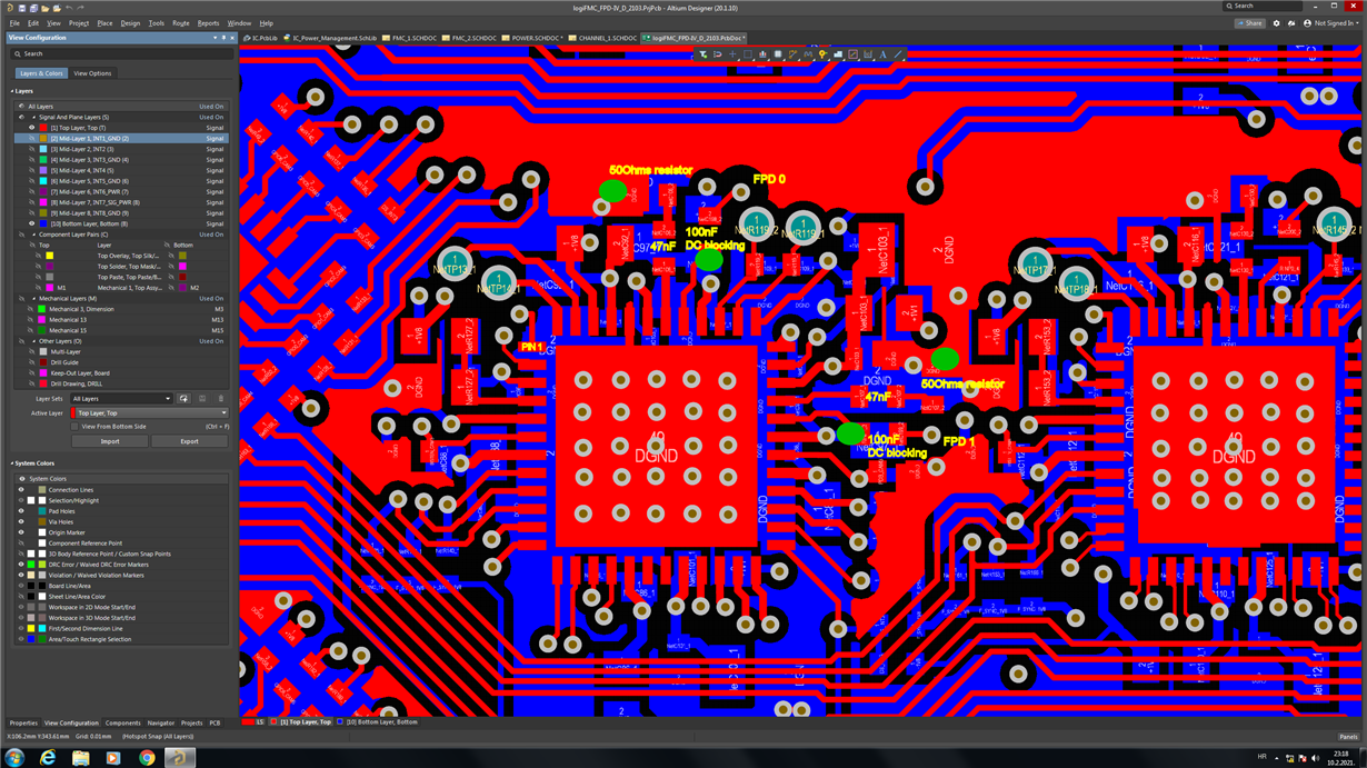

  • Hi Casey,
    I put some labels. Hope it helps. Green ellipses are the points where I was connecting coaxial cable when I was trying direct cable connection to the deserializers. Understand that we should be using stitching vias (2 or 4 of them) at the points where FPD link PCB trace changes layers (FPD PCB trace is single-ended stripline routed on internal layers), but again, even without all that channel '1' looks OK, and discarding FPD PCB trace from the picture by direct cable connection does not solve the problem. I also attached a part of the schematics showing one out of 6 deserializers  The only power supply pins where we are measuring excessive noise are the pins 3 and 20. The other power supply pins are within tolerances. I tried adding a lot of additional capacitors (10u, 100n,, 10n) directly to these pins but that did not help. Wondering constantly if there is some register tweak that we could try...
    Goran
  • Hi Casey,
    Goran
  • Hello Goran,
    What does the next layer down from the top look like especially under the high speed routing? Is it a solid ground plane? I don't see any obvious issues with the routing straight away, but it may take a more detailed level simulation analysis to see if there are any major SI differences between the total trace routing from chip to connector.
    Anyways is this an issue you are only seeing on one system? Is it consistent across multiple? The MAP results actually don't look unreasonable. Sure there is less margin on port 0, but there is still sufficient margin that I would expect the link to work well. Are you getting errors or problems with LOCK in this system?
    I would not recommend applying any register tweak. The driver/receiver is tuned to ensure performance of the link over PVT in a system which meets the SI specifications for the high speed channel. One thing you could do if you don't need the full CSI-2 BW for this application is to drop the link rate in half by setting 25Mbps back channel in register 0x58. That will drop the FC link rate to 2Gbps in synchronous mode and should give better sampling margin. That means the maximum CSI-2 rate on the 953 side also drops to 400Mbps/lane
    Casey

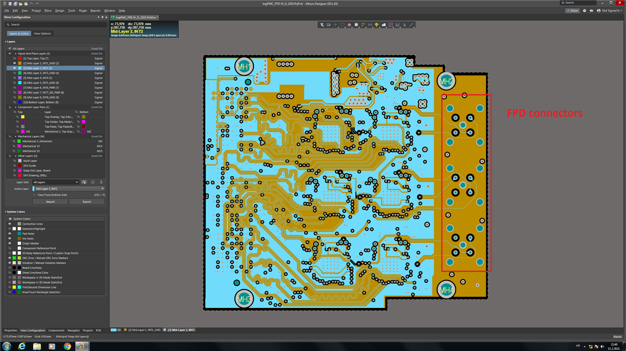

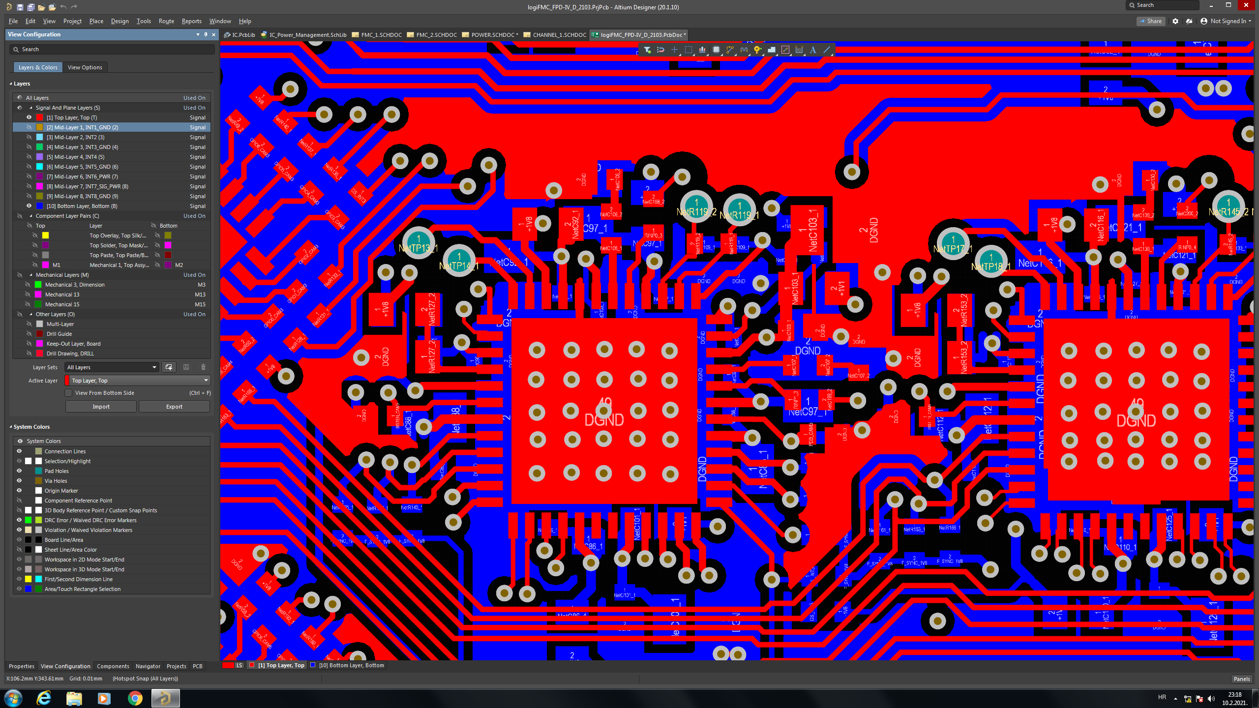

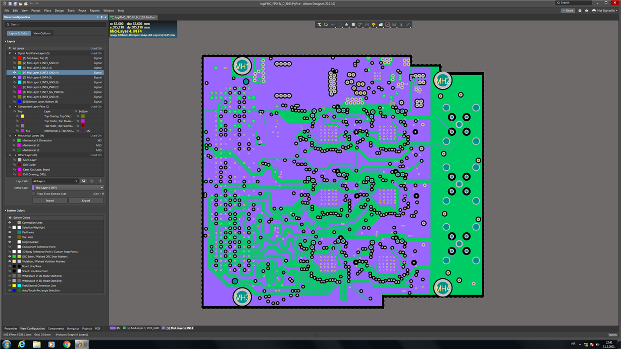

  • Hi Casey,
    I attached several more images of board's layout. We actually have a total of 4 solid GND planes. The first one is located directly under the TOP layer (Layers 1 and 2, TOPandGNDPlane.png, - check the layer list in the top left corner for the description of layers). FPD lines are routed as striplines in between two solid ground planes (INT2andGNDPlane.png and INT4andGNDPlane.png - only one plane is shown - the other is basically identical). We did SI simulation and found that impedance discontinuities are within +-10%. We are also about to perform TDR measurements on FPD lines to verify simulation results.
    Unfortunately, the issue can be observed across all the boards but it is not consistent. On one board, a channel that has a perfect MAP result may be totally unusable on the other board (MAP result doesn't even satisfy minimal requirements). That would suggest that there is something wrong with a way how boards are manufactured but we just can't see any obvious error. That's why I was hopping that you might have some ideas about what else, besides FPD link impedance, might be causing bad MAP results since that would give us some direction on where to look.
    Goran

  • Hello Goran,
    I can't see any obvious issue here in the layout that would cause a drastic difference in performance from one board to the next. But I do agree with your comment that it sounds like it could be a manufacturing issue. Have you tried reflowing one of the parts on the board which is not working well to see if the behavior changes?

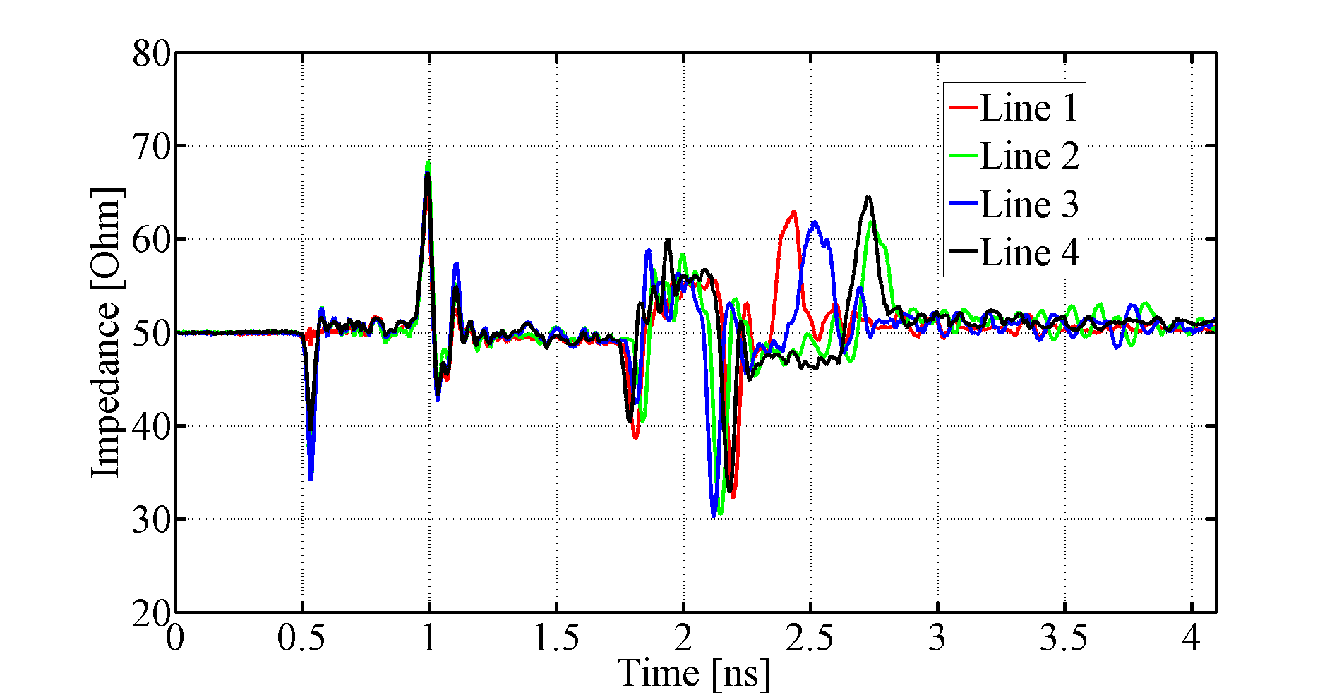

  • Hi Casey,
    Thanks for your answer. I did try to re-solder one of the deserializers (I removed it completely and then I solder it again) but  that did not help. Today we got TDR measurements of four FPD lines (attached). Lines were terminated with 50 ohms resistors. PCB connector starts at 2 ns. As you can see we have pretty big discontinuities at the input connector (impedance falls below 50 ohms) and at the VIA where signal is switching layers - impedance greater than 50 ohms (simulation results were much better). However, it looks that all four lines are equally "bad" so again, I would expect similar behavior on all the channels. Since it is not so, is it possible that the deserializer itself simply has more tolerance for FPD line imperfections on channel 1 than it has on channel 0 (Since channel 1 is OK in majority of the cases)? I am not implying here that the dserializer itself is responsible for the problem we are experiencing, just that there might be some asymmetry between channels.
    G oran
  • Hello Goran,
    Yes there may be some asymmetry from channel to channel or device to device. I do not believe for this device that there is a general trend though that channel 0 performs any worse than channel 1. For reference, if you want to make a comparison you can purchase the 954 EVM from TI.com and see how it performs channel to channel and you ca even populate one of your devices on that PCB to see if you see the same phenomenon

  • Hello Goran,

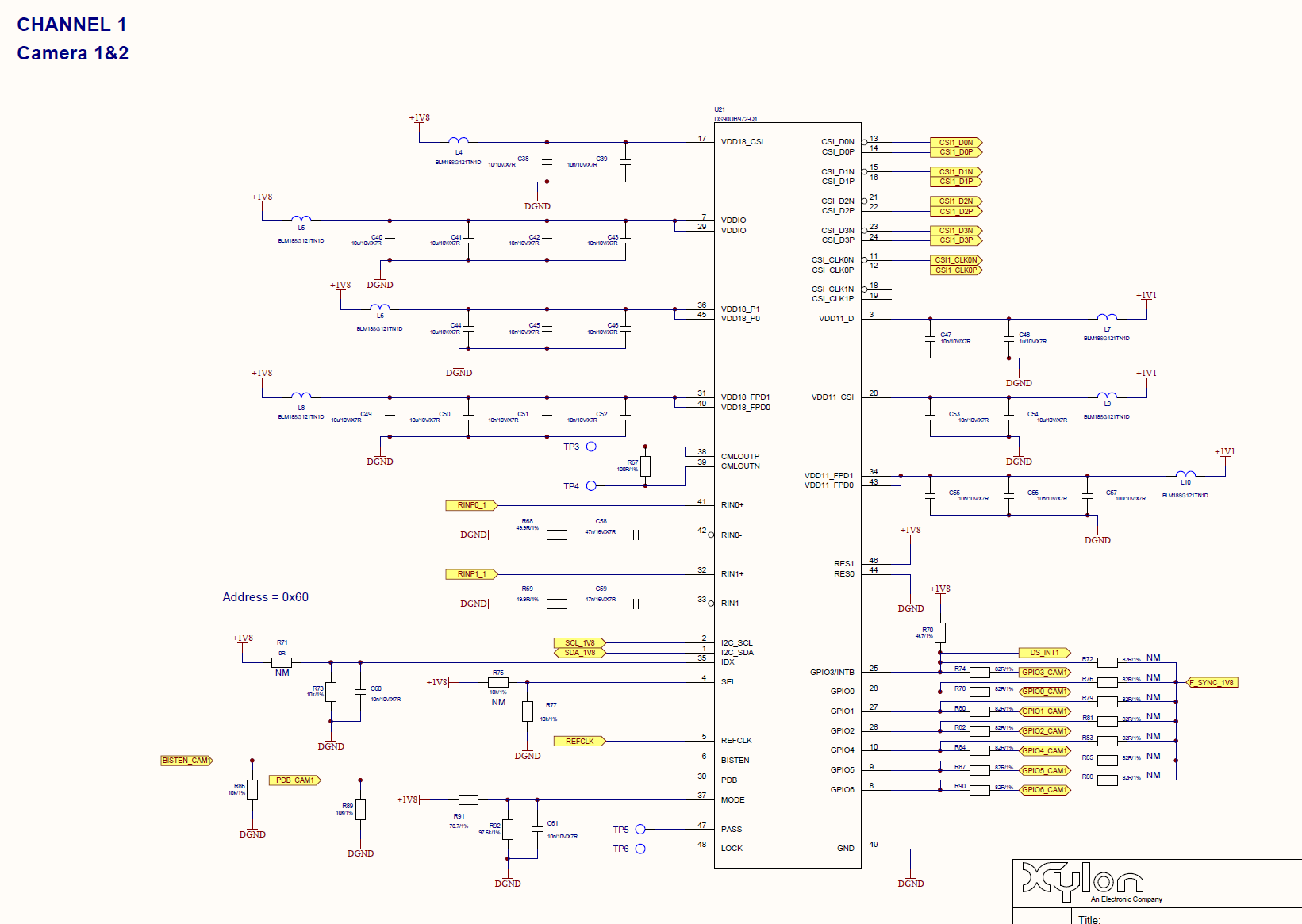

    I'm not sure what additional support you are still looking for here. My recommendation would be to first clear up the issue with the power supply ripple ~80mVpp and also see if you can get the impedance continuity closer to 50 ohms along the channel including the connector region and then revisit this.
    Also, did you ever post any snapshot of the schematic portion where you have PoC? Can you share that for review as well so we can verify the component selection?
    Casey
  • Hi Goran,
    Just curious! Do you know how TDR lab performed the TDR measurement? In my opinion, the 95x has a slower rise time where you are trying to get the fast edge. If you do, then it is too fast for the device and will never see the impedance differences. If you are going slower than the specs of 65ps then it will mask out the mismatch. I would suggest you to try out at least 45ps to 65ps.
