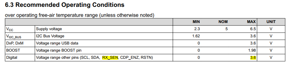

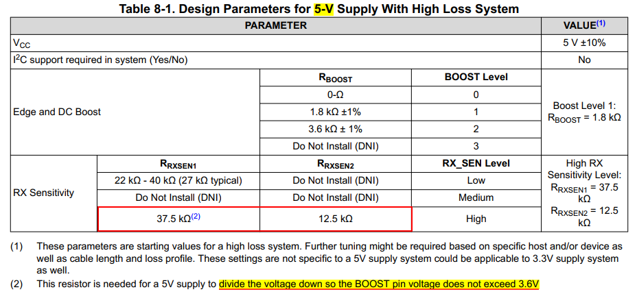

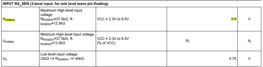

TUSB216: RX_SEN resistor choice for 5V application
Part Number: TUSB216
Dear TI,
 In my customer's design, 5V supply is used. We found the below description the voltage on RX_SEN pin should not exceed 3.6V. While if using your recommendation Rxsen1=37.5k, Rxsen2=12.5v, the V(RX_SEN)= 5* 37.5/(37.5+12.5)= 3.75V > 3.6V. It's conflicted. Please help double confirm and explain.
