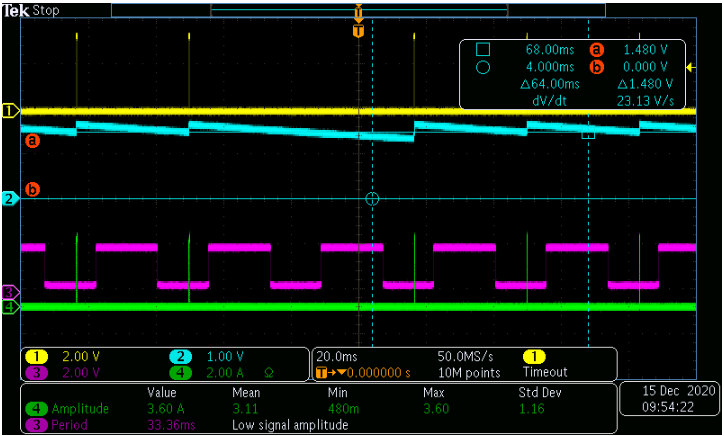

We got a setup with OV2311 -> 913 -> 954 and the vertical sync (VS) signal from the 954 is not always present.
Yellow: LED enable pulse
Blue: LED current command
Pink: Camera VS
Green: LED current
As can be seen in the scope shot, is that the camera VS is constant, but the LED stuff is missing a video frame. The LED circuit uses the 954 VS data to control the LED driver.
The 954 drives a FPGA and we have been able to capture the situation where a VS is not present.
Would it be possible to have a look at our serilaiser and deserialiser settings to see if it is all good?
Also have you had other clients with this serdes combination that reported a missing VS issue?
The video data is 10-bit raw and the frames are at 30Hz.
Couple of findings from additional testing:
  • By probing the MIPI decoder output, we can clearly see that some VSYNC pulse missing intermittently
  • And probing the 954 PASS/LOCK pin we can see them going low intermittently too.
Attached is the 954/913 init sequence.

  • Hi Tyler,
    If you're seeing lock and pass going low intermittently, then the issue is most likely related to the link.
    - Reg 0x58 should be set to 0x58.
    - Reg 0xd2 doesn't need to be set
    - Reg 0xbe isn't necessary
    I would suggest double checking the mode and make sure it's set correctly. If possible, run the margin analysis tool using our Analog LaunchPad Gui.
    Jiashow
  • Tyler, Thank you for posting the question.
     Thank you for your quick response. I'd like to add further info about the system configuration:
    -The sensor is streaming in 10bit parallel mode
    -913 is locked into the pixel clock which is set to 96Mhz (not using an external oscillator).
    And thank you for your recommendation:
    -Changing 0x58 set to 0x58 does improve I2C stability
    -Which settings specifically should we look at to double confirm the mode settings?
    -Unfortunately, we don't have the tool.
    Tri
  • Hi Tri,
    You could check reg 0x6D in the 954 to make sure it's in RAW10 mode, and  make sure 913 mode register is set to receive pclk from imager.
    If you're still experiencing problem, I would suggest downloading Analog LaunchPad:  and running the margin analysis.
    Jiashow
