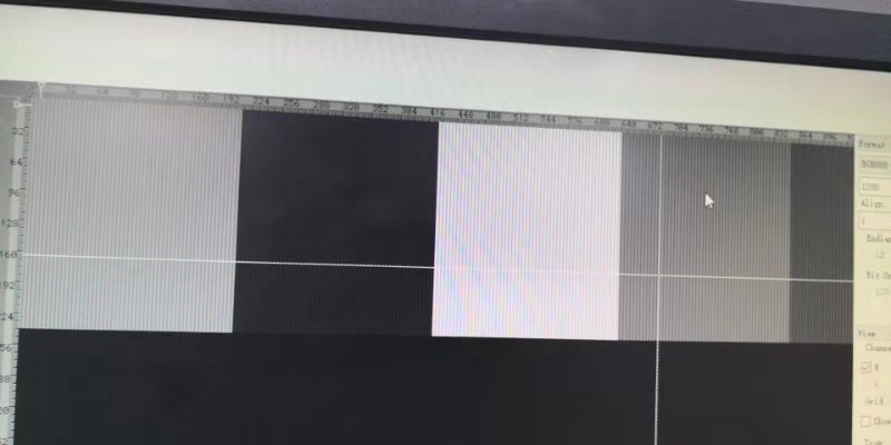

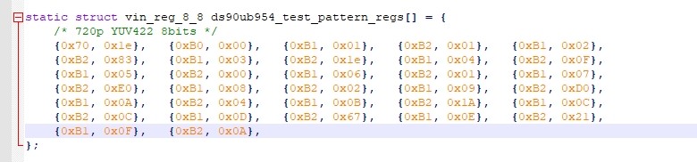

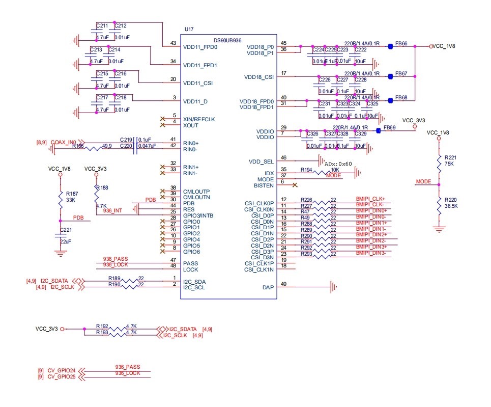

Customer have already make 933 and 936 work successfully.
But when change to 953 and 936, it failed.
May I ask what other thing do customer need to do when change from 933+936 to 953+936?
Only need to change to MODE to CSI? Or have other operation?
