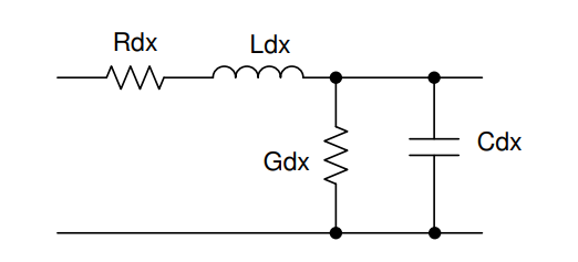

    TIA/EIA-422 defined max cable length for RS422 at 4900ft, which implies wire to wire approximate capacitance in range of 80 nF. If the driver withstands only 150 mA sinking current - then how does it even withstand discharging the circuit in its max length? For sake of an example - if circuit is just 140 ft long, which is reasonable - then 24 AWG wire is 3.5 Ohms and approximately 2.2 nF capacitance. This creates roughly between half and one amp of discharge impulse at peak which can be measured using fast current probe. This means that the chip is capable of working with much higher currents than 150mA sinking current - otherwise your chips wouldn't be capable of working with RS422 at all and they would fail.

    It's a good question. Your estimate about the capacitance is correct. However if we look closely, the cable can be segmented into many small RLC pieces.
    Therefore the capacitor are not lumped into one value. In general, if the propagation delay on the cable is longer than 6 times of the rise time of the signal, the cable should be treated as transmission line. If you're interested, this app note has many good information about transmission and signal quality.

  • Jonathan,
    The image is reattached, which is taken from this app note (Fig 9).

    I see an elevated failure rate of these chips and I am not sure what's causing it. I noticed the discharge current that varies widely from product to product. That current can be 0.6A and higher. Assuming that the failures are related to capacitive discharging I want to fix the problem by applying fix to all the devices at once. If I knew the maximum allowed discharge current of the chip - let's call that Repetitive Peak Current value - it would be easier for me to select a protective resistor. My protective resistor would be added in series with wire resistance Rdx presented in the figure above.
    So for a sake of an example if we assume Gdx to be 120 Ohms, Cdx to be 2.2 nF and Ldx=0 and Rdx=0 - I'd like to select a protective resistor value that would protect the chip from discharging overcurrent in the NPN sinking transistor.
