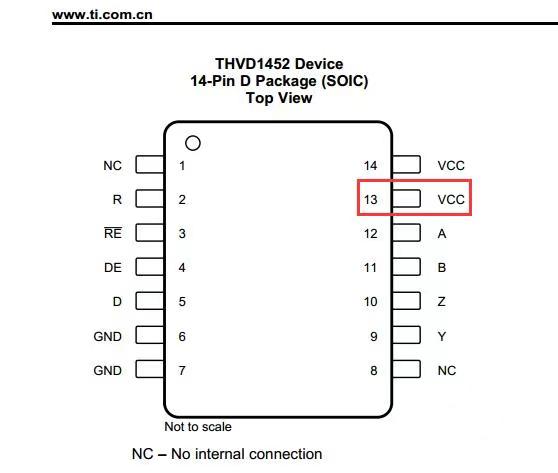

THVD1452: Can PIN13 be suspended?
Part Number: THVD1452
what if customer let the PIN13 float? the P13 of competition part is NC.
  • Hi Yuan,
    These pins are connected internally so there should be no issue leaving one of them floating if the other is connected to Vcc. Typically through, it is best to tie both pins to Vcc (less current through each pin). If a design change is possible, I'd recommend connecting both pins to Vcc. If another pin with a NC is soldered in place, this should have no impact.
