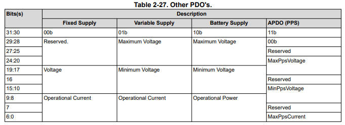

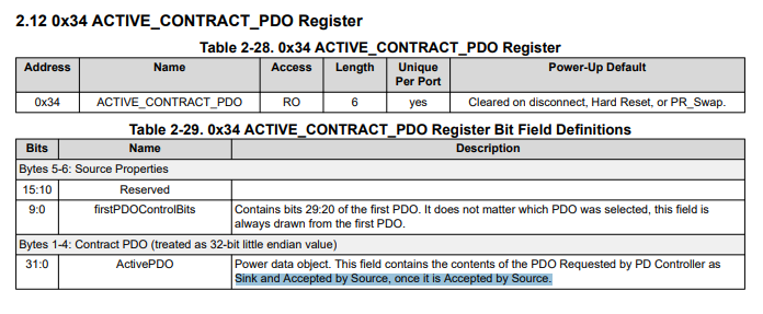

    The method to determine the negotiated PDO which is the term that we use for Voltage and current Setting is located in the TVM ()
    The register that is most likely to interest you is the ACTIVE_CONTRACT_PDO register
    The format for this register is shown on the previous page of the TRM.
