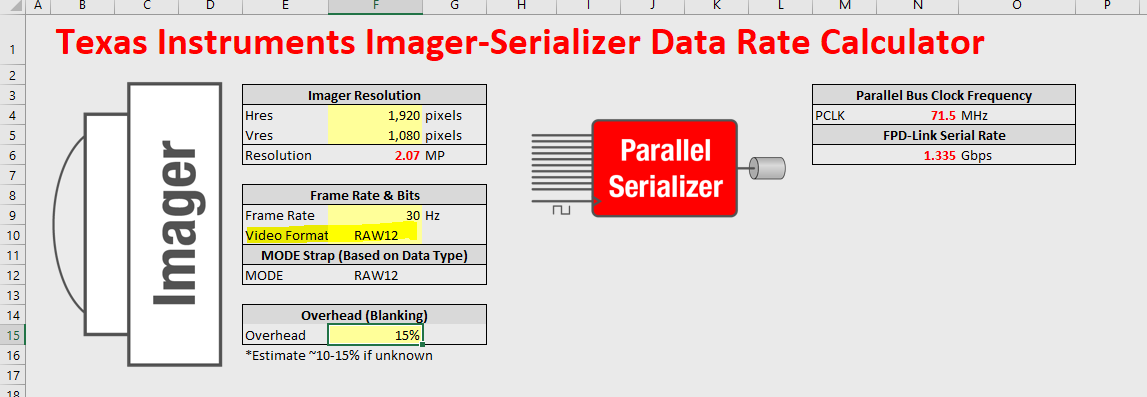

My customer is asking how to calculate the coax signal frequency when the PCLK=70MHz, and they know how to calculate the FPDLink serial rate as below calculator
Please let me know if you have any advice, thanks.

Hi James,
The serial rate you're referring to is the rate at which the forward channel is transmitted over the coax cable.

Hi Jiashow,
so this case, FC rate should be fixed at what kind of frequency?
Thanks.
Hi James,
Your FC rate is based on your PCLK. It's 1.335Gbps shown in the calculator.
