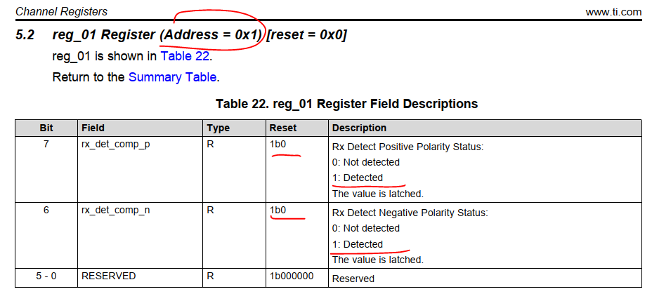

Could you please share more details about the meanings of the 0x01 register? Whether it meanings the RX detect status(1 is detected, 0 is not detected)? Thanks.

Yes your understanding is correct. "1' Means RX is detected.
Please note RX detect status is latched. This means - for example - if RX is detected(status gets latched) and then un-detected(RX termination goes away). Then at this moment if we read this register we see this bit set. To restart, RX detection circuitry, we need to use reg 0x0D[3]. This triggers RX detection process.
