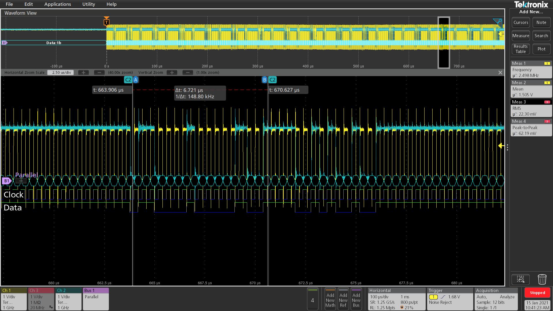

    I captured the two cases (TD_P_B   FLP presence and absence) with oscilloscope. Below is the decode from MDIO and MDC waveform:

    01 10 00010 00001 z0 0111 1001 0110 1101 (after I plugged in straight RJ45 cable)
    In both cases, the registers captured shows the same information. However, the IC behaves differently in the two cases.
    Case 1 and Case 2 are randomly happening. e.g. a system reboot might transform system from Case 1 to Case 2.
    Any possible reasons for the issue? Any advice on other items I can measure further?
    Below is the sample MDC waveform.
    Thank you very much in advance.
