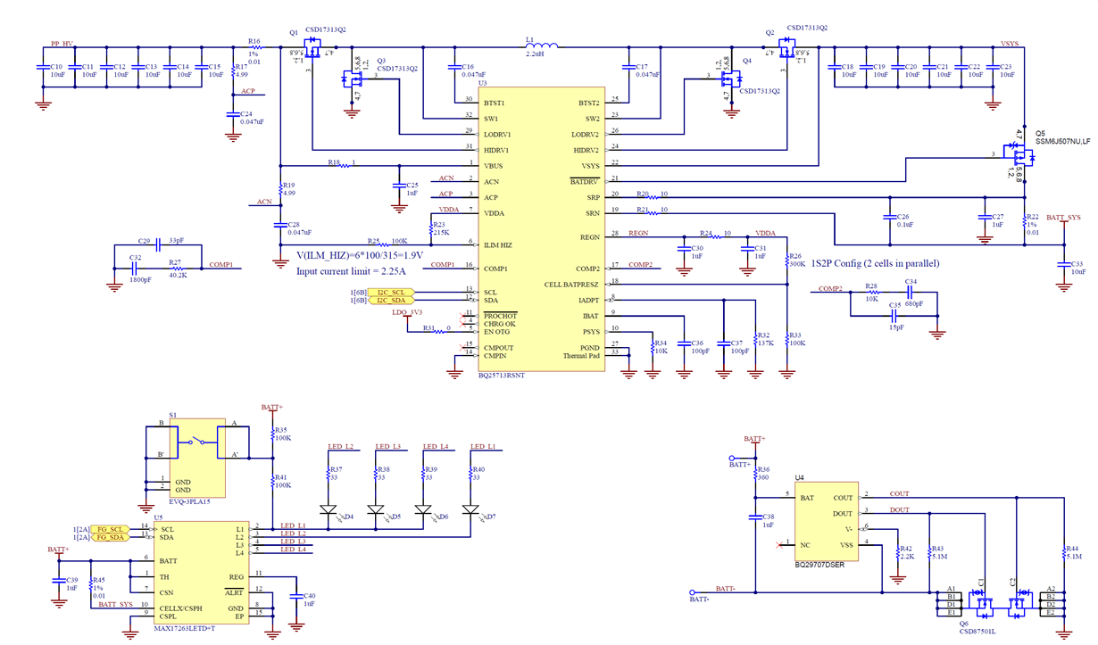

Could you please review my schematic with the BQ25713 charger?

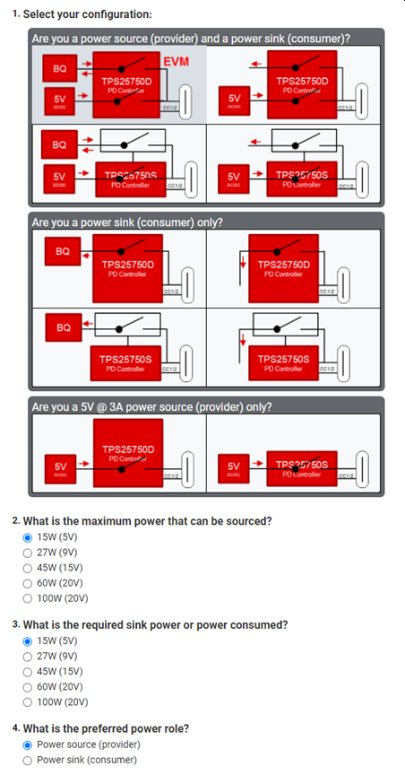

I'm using them in this mode:
The BQ25713 is connected to an 1S2P battery.
I see two issues with the TPS25750 configuration.
pin10 \i2cs_irq and pin 18 \i2cm_irq should be pulled up to LDO_3V3. This will prevent any IRQ from being triggered before the part has booted.
I do not see any issue with BQ25713, but I do not directly support that part. I suggest that you submit the same schematic to the BQ25713 team for further review by them
I also have a question regarding the Integrated USB Type-C® power delivery (PD) and charging reference design for 2-4 cell batteries" ref design.
Why are these regulators on the schematic when the VIN_3V3 net can be tied directly to LDO_3V3?
Another thing I noticed was the ref design grounded pin 10 and 18 on the TPS25750. Is that incorrect?
I have another customer design that currently has an issue with having I2Cm_IRQ causing boot issues. This is a single design with multiple other designs not having the same issue. While I complete this debug, I am suggesting that all customers pull I2Cm_IRQ and I2Cs_IRQ high because this will not impact any other system performance and may resolve a potential future issue.
Many other designs to not see this issue, so I am suggesting the change as an abundance of caution.
