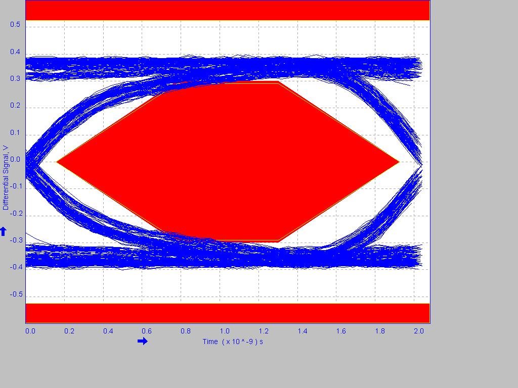

Hi team,
My customer found high speed fail of the usb2. But it can pass when whey remove TS3USB30ERSWR mux.
The trace length just 8421 mil (Spec. 17800 mil).
D+: 8419.48 mil
D-: 8421.22 mil
Now, I recommend customer to add redriver. however, I have some questions about our solution as below.
1. According to eye pattern result, TUSB211 would be suitable for customer or TUSB212? Why?
2. should I place redriver close to connector or USB host?
3. For TUSB212 in I2C mode, What is the result if AC_BOOST HW setting is level 2 then I set 0x01 to level 0 by I2C?
