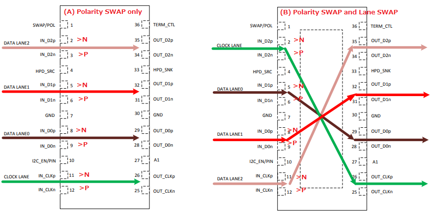

At SWAP/POL=High, (Re-timer mode)
Which is correct below?
Also, just "input polarity" will change at SWAP/POL=High, right?

The TMDS181 support polarity and lane swap at the input signals.
When input lane SWAP and Polarity control pin,
SWAP/POL = H: receive lanes polarity swap (retimer mode only) -> Block diagram A
SWAP/POL = L: receive lanes swap (redriver and retimer mode) -> Block diagram B without polarity swap
