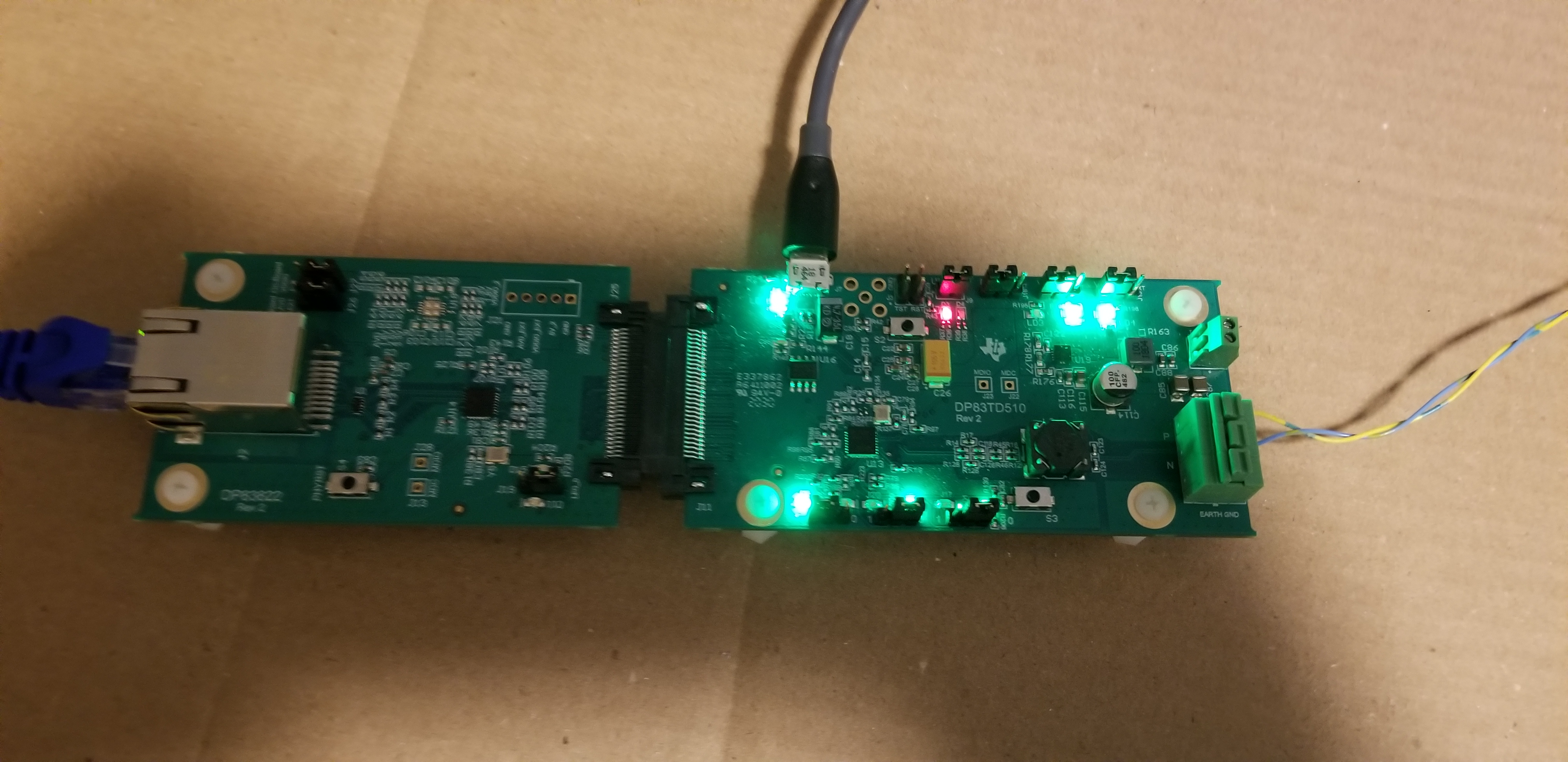

So far after searching the forums I found that I had to replace R24 to 0R (only way to get the COM ports to show in windows).  That made it appear to work better as LEDs are now properly bright.  I seem to get link after about 10 seconds on the T1L side (maybe longer) (is that normal time?).  I am only using about 15 feet of shielded cat 5e using 1 pair and the shield cable.  So far I have only seen 4 packets actually pass through undamaged.  I have not run any scripts as I was under the impression by the documentation for what I am doing, that it isn't required.

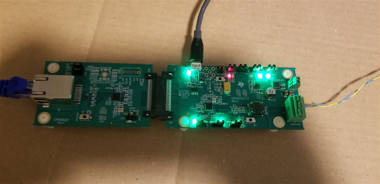

    To note, Had to power the one board I am serially connected to via USB, as it didn't seem to like USB and Bench supply at the same time.. Kept losing link on the RJ45 side (and other issues im sure).  I attached a pic to show the LEDs and jumper posistions.

  • Hello Ian,
    Looks like the silicon version on your EVM is not the one under production. Do you have access to the production silicon? If not, you may have to load a software configuration in the device for the required performance. For the required software configuration, do let me know the following about the desired mode of operation :

  • Vikram,
    I was given a AutoNeg initialization script, and after trying it, it now works.  I think I attached it to this message for other users.
    Interesting about the silicon. Our rep actually had us wait for the dev kits which have the newer silicon, so that is what I thought we got.
    Thanks!
    Ian
