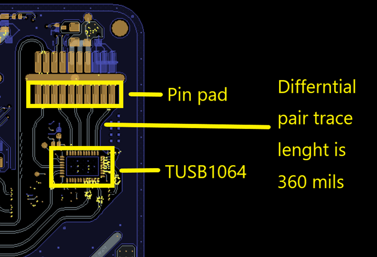

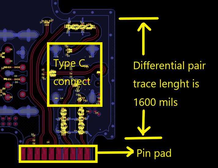

Currently the type-c connector is implemented on a small board which will be mounted to the main board directly through a 10-pin pad.  So, the total trace length would be summarized as below.  Do you think we can support such implementation?
  • On the small board, the super speed signal traces length from the type0c connector to the 10-pin pad is around 1600 mil as below.
  • On the main board, the super speed signal traces length from the 10-pin pad to TUSB1064 is around 360 mil.
  • The signal loss on the pad itself is unknown.
