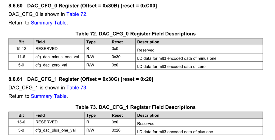

When the DP83825I is power on or reset operation, do DAC_CFG_X Registers return to default vaule?
<Question2>
Do the value of DAC_CFG_X Registers adjust automatically with communication condition ?
We assume that there is no automatical adjustment.
