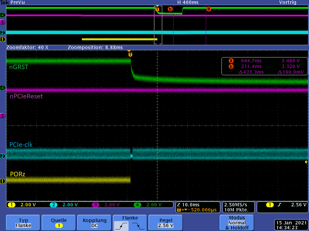

we observe a reset behaviour of this PCIe-PCI-bridge. There is a little drop in the pcie clock and then the device seems to reset itself.The PCIeReset is stable all the time.
The GRST pin only has a capacitor to ground and no external source.
The questions:
Indicate this GRST signal sequence that an internal reset occurs?
Can a little drop of the pcie-clock perform this internal reset of the bridge?
Thanks and regards
  • Greetings,
    Yes your understanding is correct. Given nGRST got generated. It seems there was an internal reset. GRST is a global reset and when it is asserted all registers, state machine, digital logic, and analog circuit are returned to power-up default state. In a typical application or if there is no need for a reset, GRST can simply be left floating. There is internal pullup resistor that guarantees a non-reset condition.
    No PCIe clock may trigger GRST however it has not been characterized.
